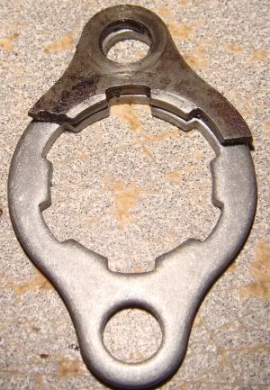

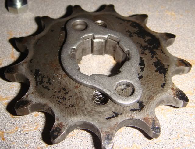

    My 250r was missing most of the clip that holds the drive gear on the motor so I ordered one from Honda.
    Went to put it on... but I can't. If I line up the holes with the gear, it doesn't fit the splines. If I match the splines, the screw holes don't line up.
    The clip appears to match up perfectly to the piece I removed.
    WTF???

    its not supposed to line up it need to be offset to hold the gear on

    I couldn't figure out how to get it on though...

    your countershaft should have a slot cut in it. mount sprocket push all the way on, then slip retainer lock on and rotate it in the slot until bolt holes line up.

    lol... TADAA!! its amazing taking a step back...

    Ohhhhhhhhhhhh... it rotates. I didn't have the gear on far enough.

    Just a week ago I was helping my buddy with his KXF250, I let him do the "easy" stuff like graphics, chain and sprocket etc etc.
    I was putting it in neutral and I noticed the sprocket clip (another attachment method) seemed open. I looked a little further and said "WTF did you do with this?" He honestly thought the clip just had to rest on the splines and didn't have to go in a groove or anything All he had to do was push it towards the sprocket.
    He wouldn't have gotten too far the way it was.
