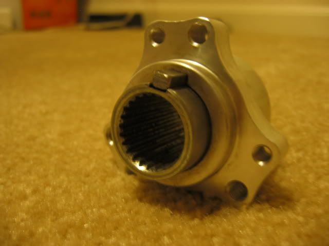

    My Hubs For kart wheels
    Well I worked with the local machine shop with machining the stock 70 hubs to work with the kart hubs I bought to work with the kart 6" wheels I bought. Here is what I've come up with:
    [IMG][/IMG]
    What I did was had the triangle part of the main spline machined off and then had a channel cut into the spline to accept the 1/4 key stock which will mate to the 1/4 key for the kart hubs. Now this is the way I wanted it so that all I have to do to change the rear wheels is swap the complete hub. $90 machine time and $35 for the kart hubs and key stock. I don't have a lot of time or equipment to do things myself so this is what I came up with. I ordered my Piranha 140cc motor tonight so I need to know of any fitment issues with the intake and the tank. Thanks! Things are slowly coming along. Frame, stock wheels and a few other parts are headed out for powder coating next week. Getting close!

    that is what i thought would be a good way of doing the mod but i was going to make a splined sleeve and use a kart hub for a 1 1/4" axle

    hub looks good henry! as far as fitment issues with the tank ive seen two ways of doing it...one big specht on here did was to cut the bottom of the tank and make a recess in it(takes a little work but looks good) the other which is what i did was on www.dratv.com they sell turn out and low bend intakes for the bigger carbs..seems to work pretty good sometimes with those intakes you have to grind a few of the fins on the back of the motor down a little to get the bowl to clear... just look and see what carb and intake comes with the motor kiser on here didnt have to much trouble fitting his and didnt have to change andything.. good luck! if ya want some pics i can take some and post them for ya
