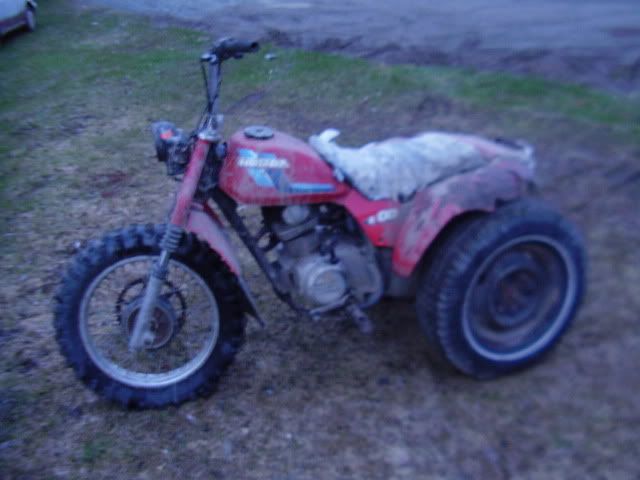

    Quote Originally Posted by daniel_250r View Post
    http://www.youtube.com/watch?v=VTBvF...e=channel_page this guy has tractor tires on the back and rt 185 forks it looks jacked
    Looks like the 200S i made last spring, had 14" bias ply town & Country tires on the back and the rear tire off of a TT600 on the front. Went anywhere, through snow and water it would keep plugging along no problems. Though I did end up reversing the wheels to widen it out some in the rear.
