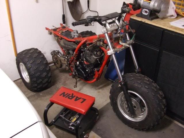

    Well I have made up my mind for my 85 200x. We ride A lot of woods around here and I am going to try to build my 200x to fit that as good as I can. It going to have to have some good ground clearence, versitile in numerous types of terrain, be able to climb, jump, hop logs, get through mud, and pull buddies off logs and out of mud. I want it to look nice when it's done but Im not going for a resto grade finish. I am doing this on a budget so most everything is going to be done with paint and used parts.
    I picked this puppy up 2 weeks ago and The pull start was broke and the throttle top was off the carb. After we fixed those problems I found that the back brake was locked up, the sprocket is extremley loose, The hack welded a redneck grab bar, hack welded a trailer receiver on, hack welded the shifter back on, and they hack welded a socket for the rear brake lever pivot. As I leanred more on this sight I realized that I have a 84 200m engine on my 200x but without the electric start hooked up. After a lot of thinking about the the fact that it has the lowesr compression ratio and an auto trans and I fell further and further away from liking the engine in it. I had planned on putting a xr200 engine in and calling it a day. But after I thught about it I decided that the auto trans would be nice and so would electric start, so I started to dream up this build.....
    Things wrong:
    all the crappy weld jobs
    the slow engine
    engine blows lots of smoke
    transmission shifts hard
    The build plan:
    Engine- Keep the case, add electric start, xr200 or 200x head with xr200 piston
    Intake/exhaust- stock pipe sanded and painted, heat sheild polished, 450f titanium silencer, New uni air filter, custom airbox lid.
    Suspension- new oil and seals in forks, still learning about the old rear shock.?.?
    Tires- Down size to 20" rear tires to help with stability but keep ground clearance(type undecided), Front tire(undecided).
    Plastics- Would like to attempt to create some custom ones from a newer atv or just get ones that are not broke.
    Other- cistom fabricated grab bar, nerf bars, skid plate, case saver, and sprocket and rotor guard.
    But first I need to worry about the major problems and once those are gone then I can start the real fun. First I am going to ride it for a couple weeks since I just got it then I will begin the disassembly on her. I am hoping to be done by winter time because then once I put my dirtbike away I can still ride.
    Any one who has any suggestions or any tips for helping me with any of the things that are wrong just say what you have to say, I am new to trikes so bear with me as I learn.

    Well I got some more work done on here. I cut the ugly welds off on the exhaust and grab bar and now started to weld up the new grab bar. I also realized that they welded a tow hith to the swing arm! OMG this project is getting harder and harder. I thought the engine was toast because it was blowing smoke like no other but now that there is no silencer on it it dont smoke a bit so I am thinking that the packing was soaked with oil. BTW I dont know if I want to put the silencer back on...Its mean sounding!!LOL Later I will post up the pics on here and I also have a question about the carb. I have a pic but I need to know if anyone can ID it as a 84 200m carb ot the 200x carb. Also what are the diferences in these and also The fact that I cant get the thing tuned to run very good. It runs but it wont idle unless the idle is set high and it likes to pop and crack a lot, It has fuel pouring out of the overflow unless you adjust the screw then it just comes out of the gasketless float bowl. And lastley what is the correst float setting for the carb.
