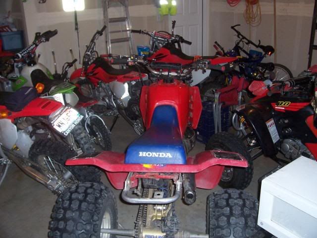

    well i got a 86 atc250R for 600$ it runs good but the forks need help and the rest needs powdercoating. When I took the forks off the left one wont come apart the crome is chiped there was no oil in it. I took the sirclip out under the seal all I could get out it the 2 springs the washer and a pice that was a foot or so long. I tried to heat the outside of the fork to pull it apart after the and it wont work. and with all the chips in the crome I dont think new seals would hold oil. anyone have a left fork for sale for a 86? I dont have a clue were to find parts for it . I was going to do a frame up restore on it
    some pics when I got it
    and now I tryed to fix some stuff
