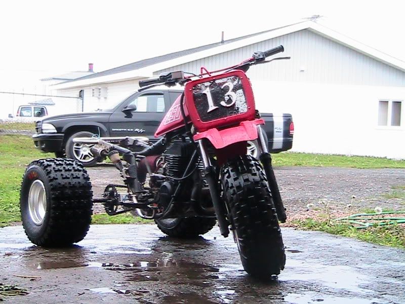

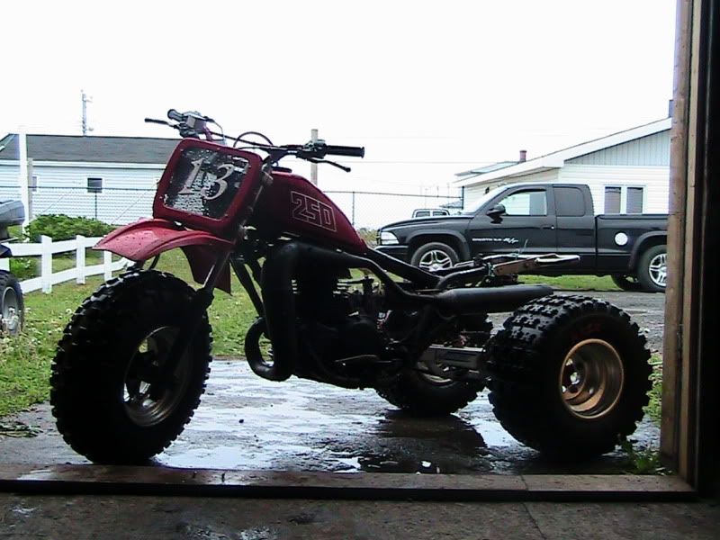

    i putt 85 250r fender on my 200x looks sweet
    85 200x-redone frame up,extened rear axel,clarke plastic gas tank,dg exaust system,ceet atc seat cover,and much more....
