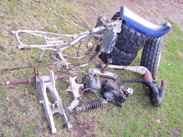

    i bought this from a member on here about a year ago. at first the parts didn't look bad till i looked harder. needed more than i thought. took me almost a year searching for parts. a few members on here helped me out with parts and most of the rest i found on ebay. i rebuilt, fixed, or made every little part on this. it should be a reliable rider. i have enough cash into it!
    this is what i started with. engine was junk

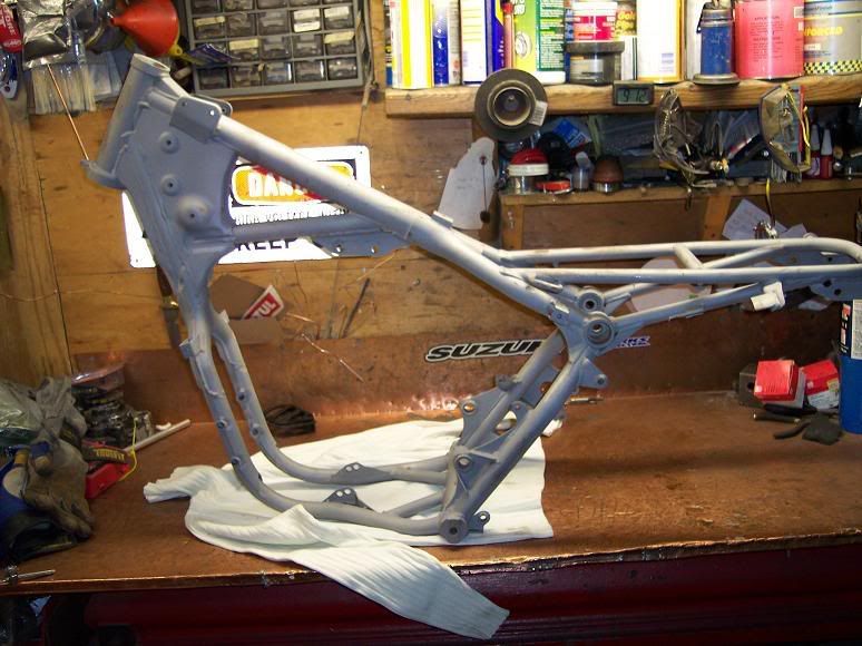

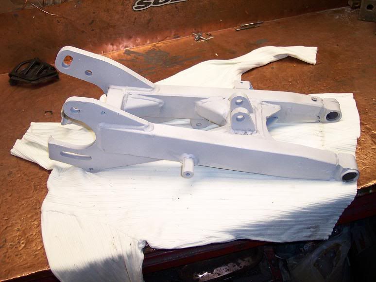

    frame and swinger had alot of cracks. had to weld up both. painted the frame pj1 blue. was going to get it powdercoated, by a friend of a friend but he took too long and i couldn't wait. plus really didn't want to put anymore cash into it. heres the frame.

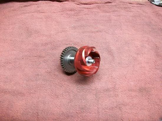

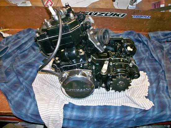

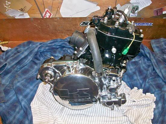

    heres the engine. bored 50 over with a wiesco piston, deck was milled 15 thousandths to clean up the sleeve. all new engine bearings, seals, gaskets, waterpump shaft, yamahondaman billet impeller (modified triz impeller), kawasaki rod kit, ricky stator and flywheel. i had to open the ports up on the sleeve to match the casing, the sleeve blocked alot of the ports. thats a kx intake boot with boyseen reeds. i have a new original intake boot but need an airbox to run it with.
    greg king polished the clutch cover, and a few other parts for me.

    real nice... getting ready to tear into my 85 motor this winter.

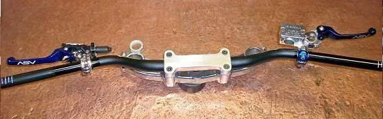

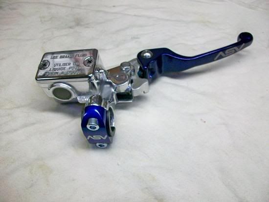

    handlebar set up. asv levers, pro taper fat bars, with a custom bar clamp.

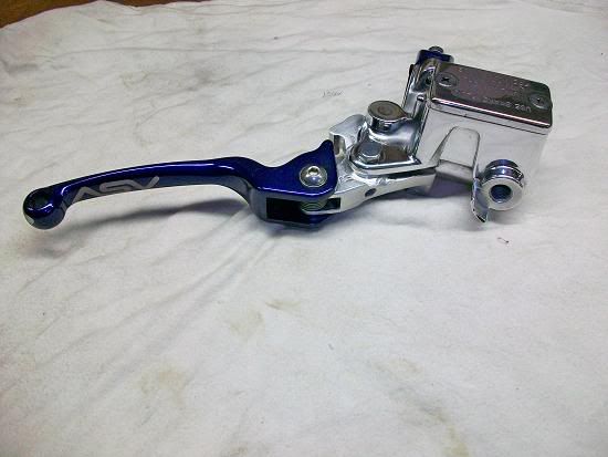

    stock tecate front master cylinder with a yfz450r asv lever made to fit. insides replaced with a new lt250r rebuild kit.

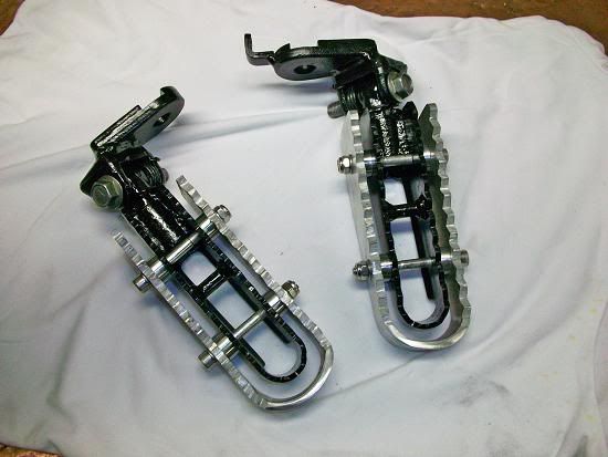

    footpegs, made them wider, custom fat pegs.

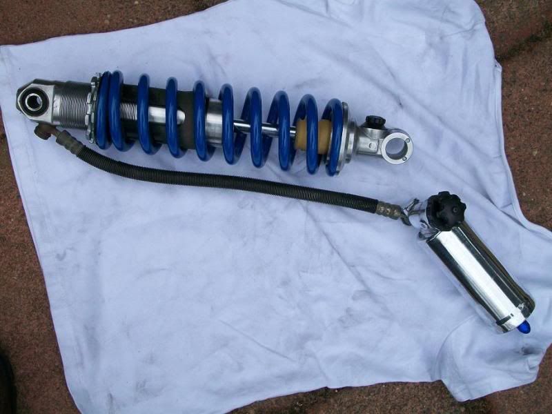

    rebuilt rear shock. the upper spherical bearing can be changed out with a needle bearing, which fits perfect. and is alot cheaper then the bearing from kawasaki. if you can still get it.

    that water pump looks familiar...I like that peg set up
    thanks bryan, it worked out good.

    what did you make those peg extension out of? looks like 1/4" aluminum plate? did you bend it and then notch all of it?
