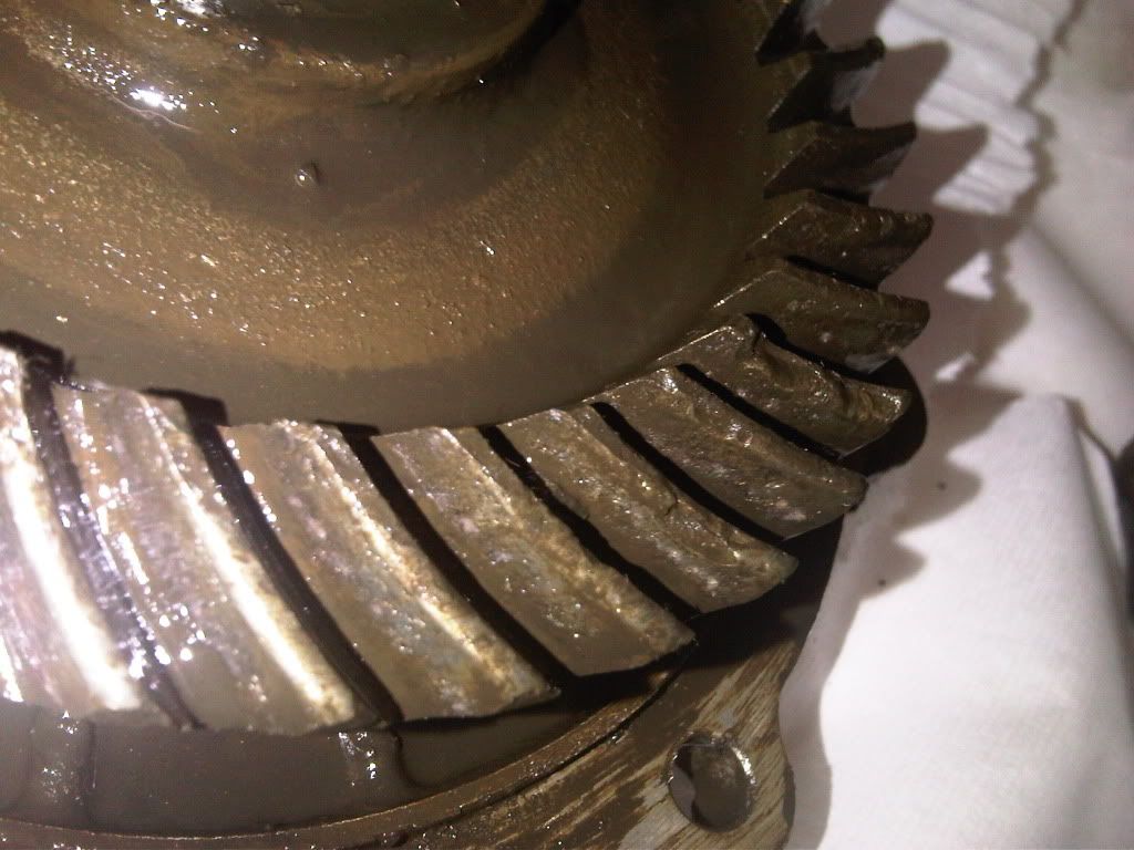

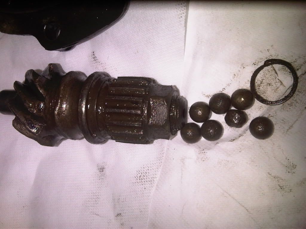

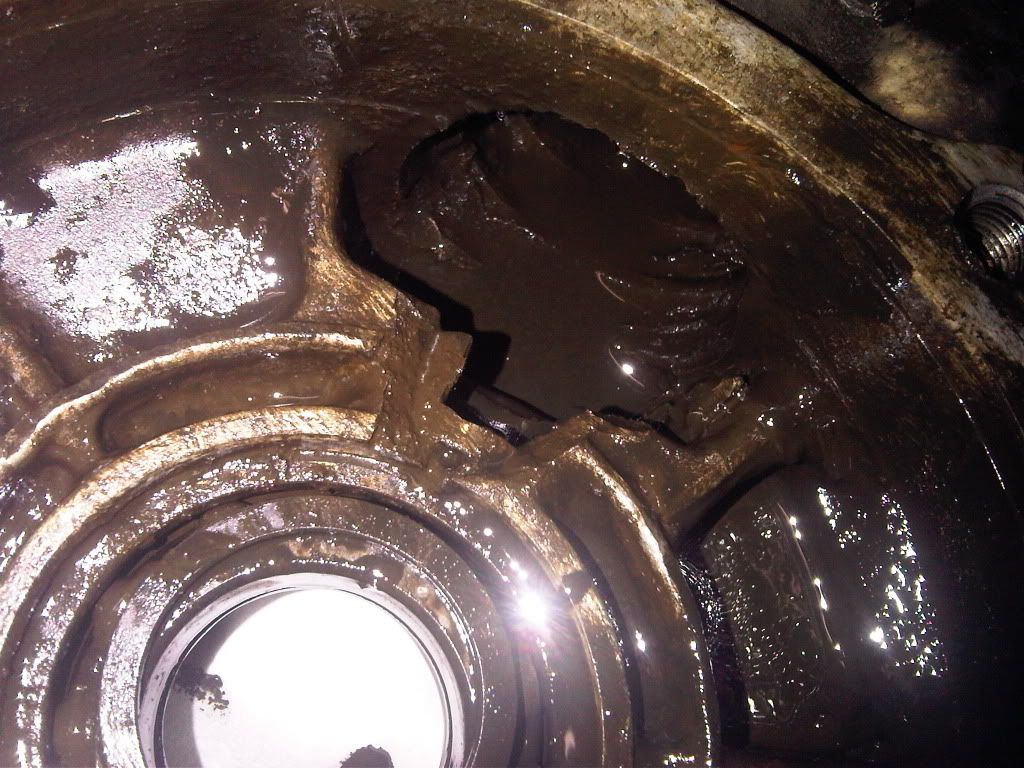

    85 250es Rearend. 1st off i knew I was in trouble when I pulled the drain bolt and nothing came out.... I mean not a single drop at all........
    Pinion bearings
    Where the pinion decided it didnt want to live no more
    More parts of the pinion bearing area
    Ring gear damage
    I have a strong feeling this was caused by no lube, Or just the bearing wore out and no one cared to check into what was making the noise. Just use this as a reminder to check fluid and bearings on the diffs guys !

    Sadly the case is messed up and the big red is really too far gone to put back together. It will be getting parted out in the classified section soon!
