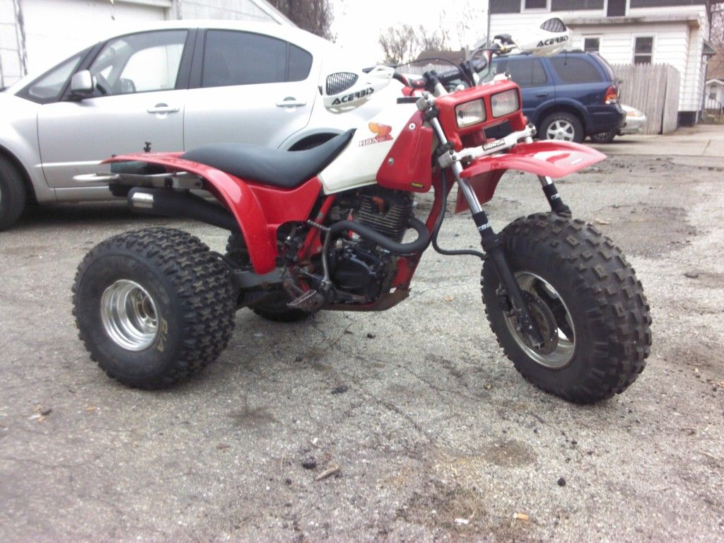

    I will add to the shots....this one is an 86 front fender.

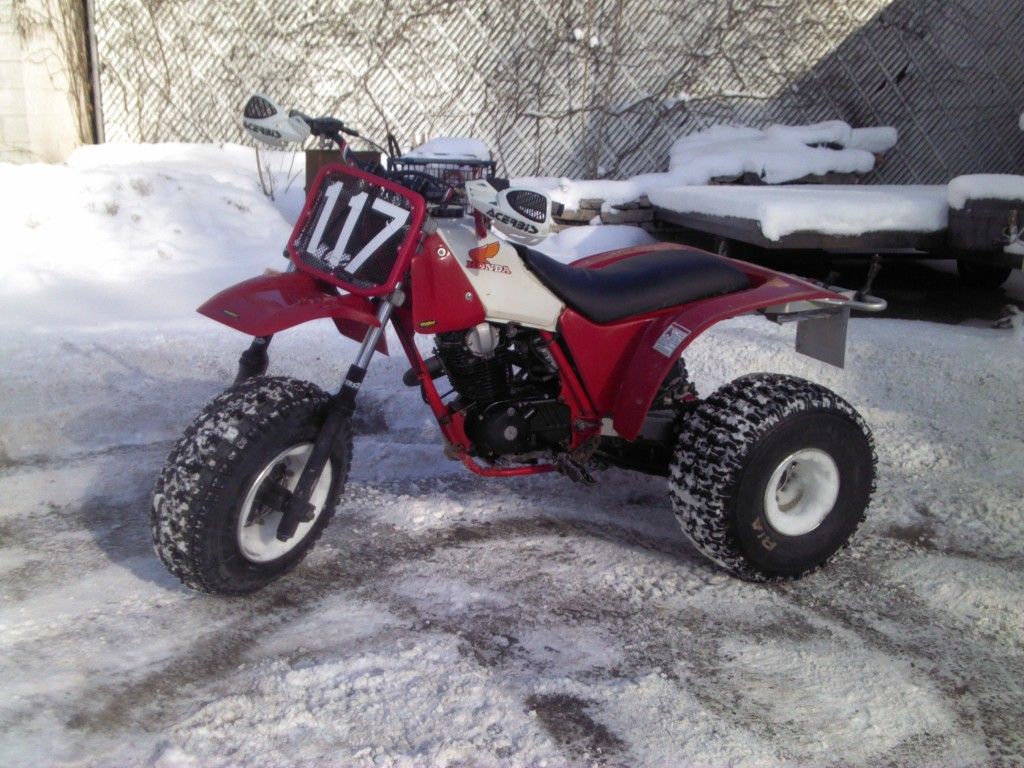

    Also an '86 front
    1984 ATC 200XR
    1984 ATC 300R
    1983 ATC 88
    Feedback for Mike Pargiello
