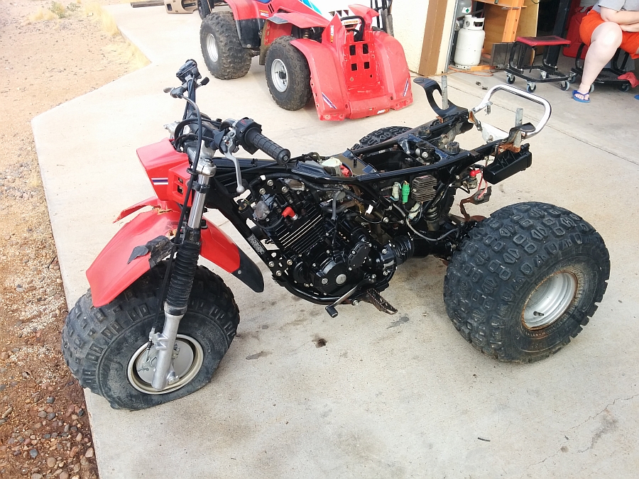

    I picked up a '85 250SX a few weeks back for basically $100. It had been sitting neglected for a few years in the back field. PO decided to put it on Craigslist with a little pull behind trailer so I nabbed the whole lot for $200. He said it had not ran in a year but with the condition everything was in and how disintegrated the front tire was I am willing to bet a few years. Either way the motor turned over with good compression so I took a gamble. I only got a bill of sale and until the title process was finished I wasn't putting one finger on it in case someone tried to claim ti during the process. Luckily though no one did and now its all mine with a clear title!
    I was not sure of the full condition of the motor so I did the bare minimal to see if it would run. Changed the oil and filter. cleaned the carb, put some deep creep in the top end to lube it up a bit and a new spark plug. I grabbed the battery from my XR650L and a quick prime and a second on the starter button and it fired right up! I even got a video of it starting for the first time in years.
    Well it fired up and ran so its all fair game now. First with the cleaning.
    This was the day it came home

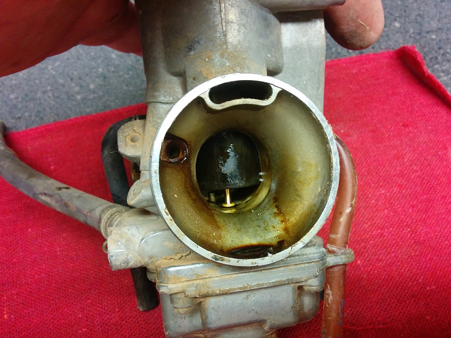

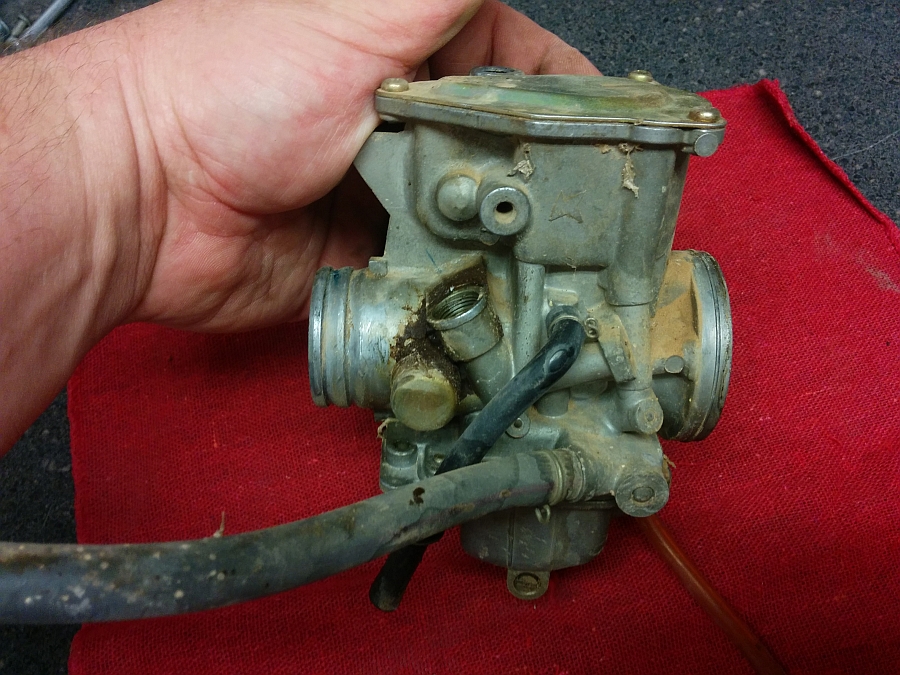

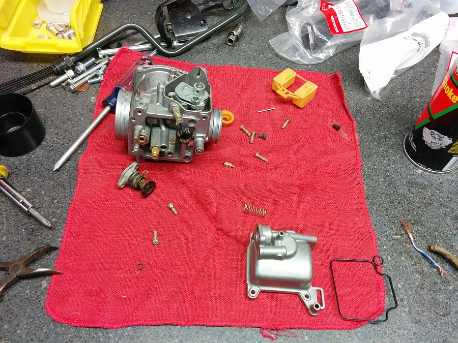

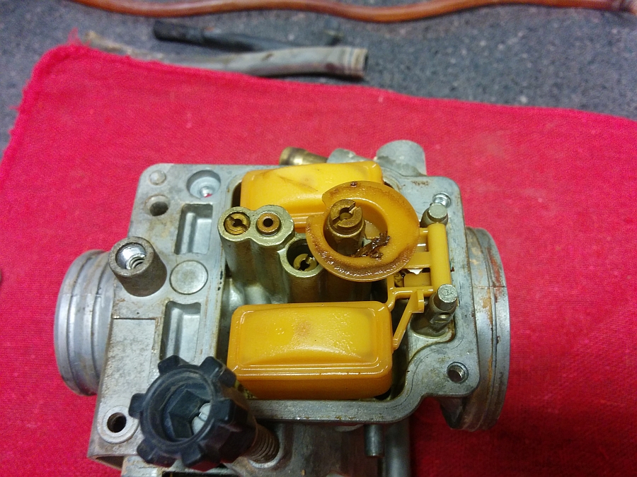

    Cleaning the carb. Man this was some of the thickest turpentine Ive ever seen. Pull the slide up and it just sat there slowly sliming its way down.

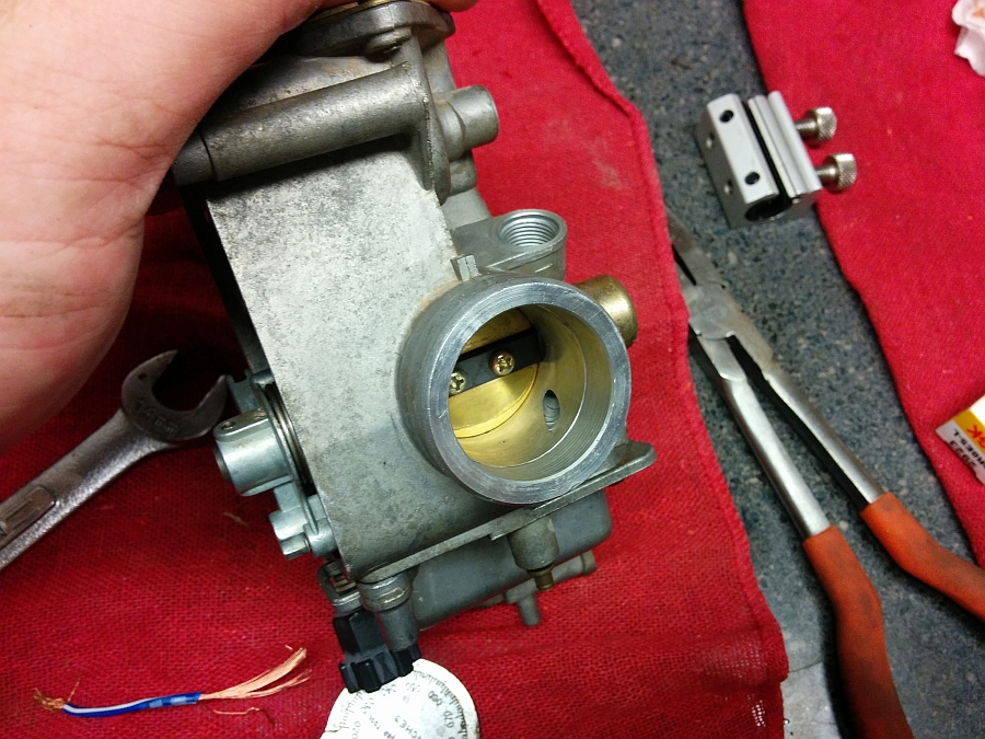

    After the cleaning. I didn't put no new parts or gaskets in because I didn't want to put any money into this if it was shot.I got lucky as you can see in the video the carb held together and didn't leak.

    Her former glory is starting to shine through after all these years.

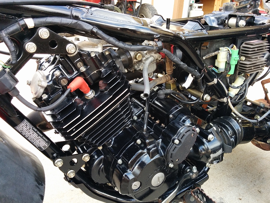

    Along with cleaning her up I also made a quick trip down to Tucson and scored a 1985 250SX motor with harness, controls, carb, exhaust, airbox and rear swing arm assembly with drive shaft for $150. The plan is to rebuild that motor down the road and then swap it out.

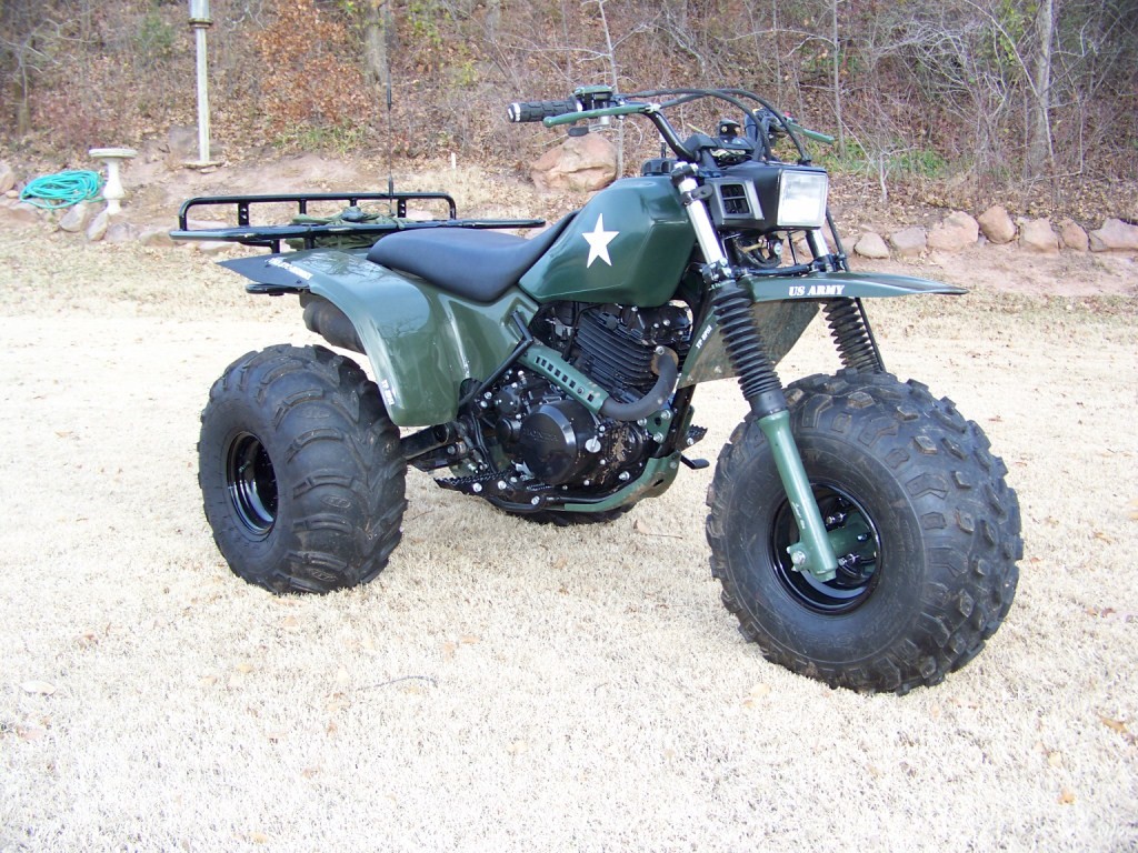

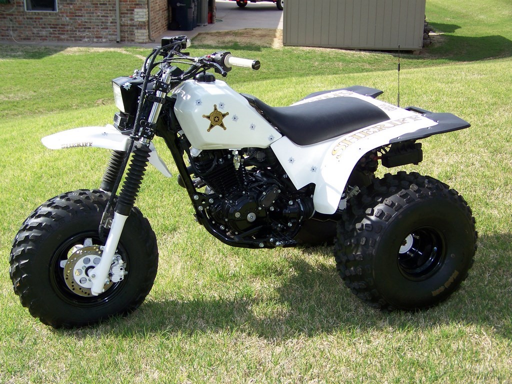

    Nice score. The SX is my favorite trike. I've done ground up rebuilds on several. That's the one they will pry from my cold dead hands. My daily driver is the one with the white star. The others I've sold.

    Does rubbing alcohol,really work? Does it break all the dirt and hardened gas down? Never thought of using that before.

    I use 99% Isopropyl alcohol (technical grade)for many things. For the carbs, It dries out any residual varnish, dirt, or whatever is on the carbs. It makes bead blasting the bodies and bowls go faster. My cleaning process is done in several steps but the final step is to shoot carb cleaner through all the holes in the carb. I prefer to soak the carbs in Heptane but that stuff is a little spendy. Alcohol works pretty good and it doesn't leave any residue behind. I also use alcohol to clean and degrease parts prior to powder coat. Isopropyl alcohol has many uses. I buy it by the gallon on Ebay.
