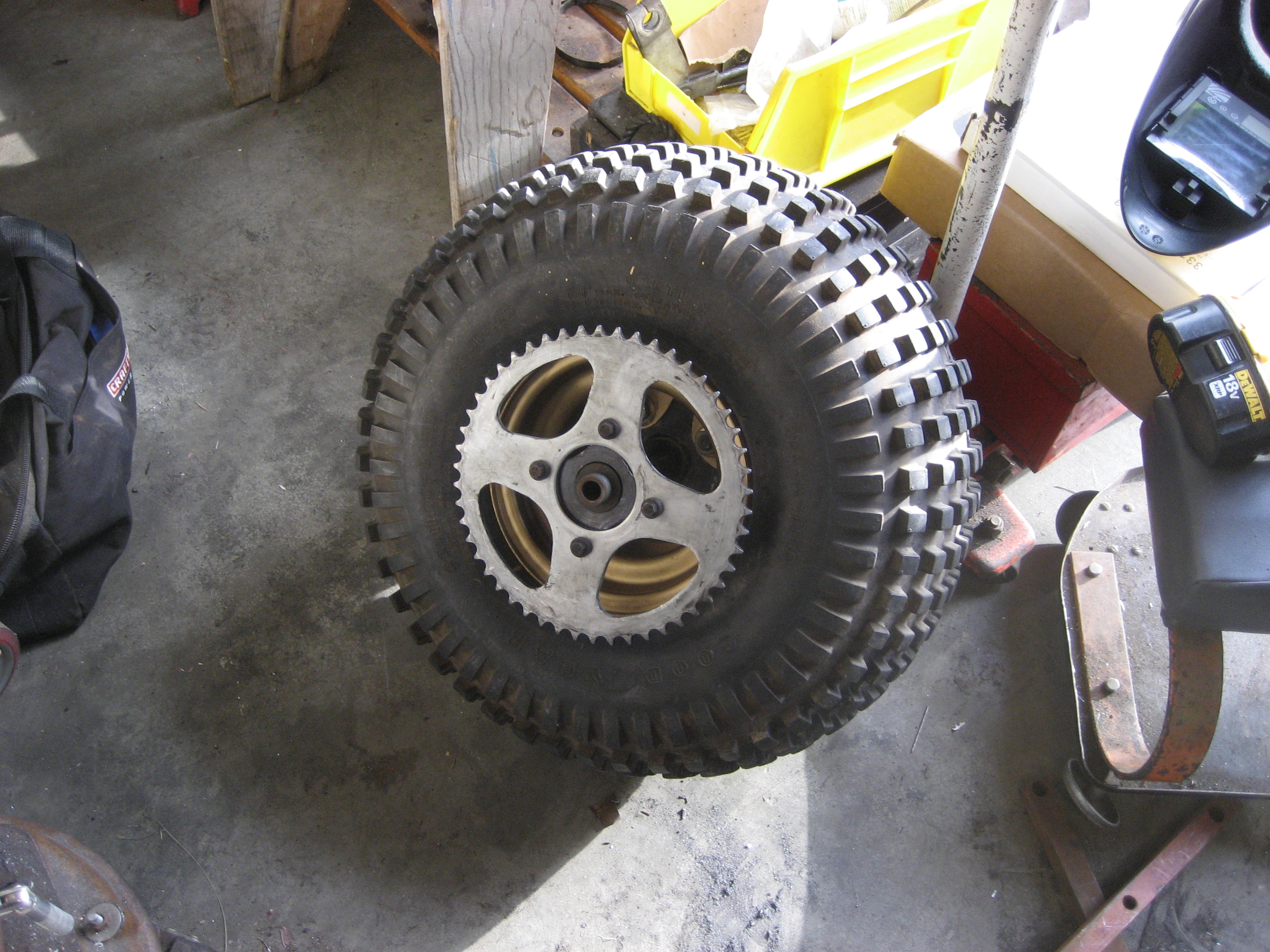

    Rear axle/ hub assembly.
    Yes that's an actual can of GOLD wheel paint. C'mon. This thing is legit.

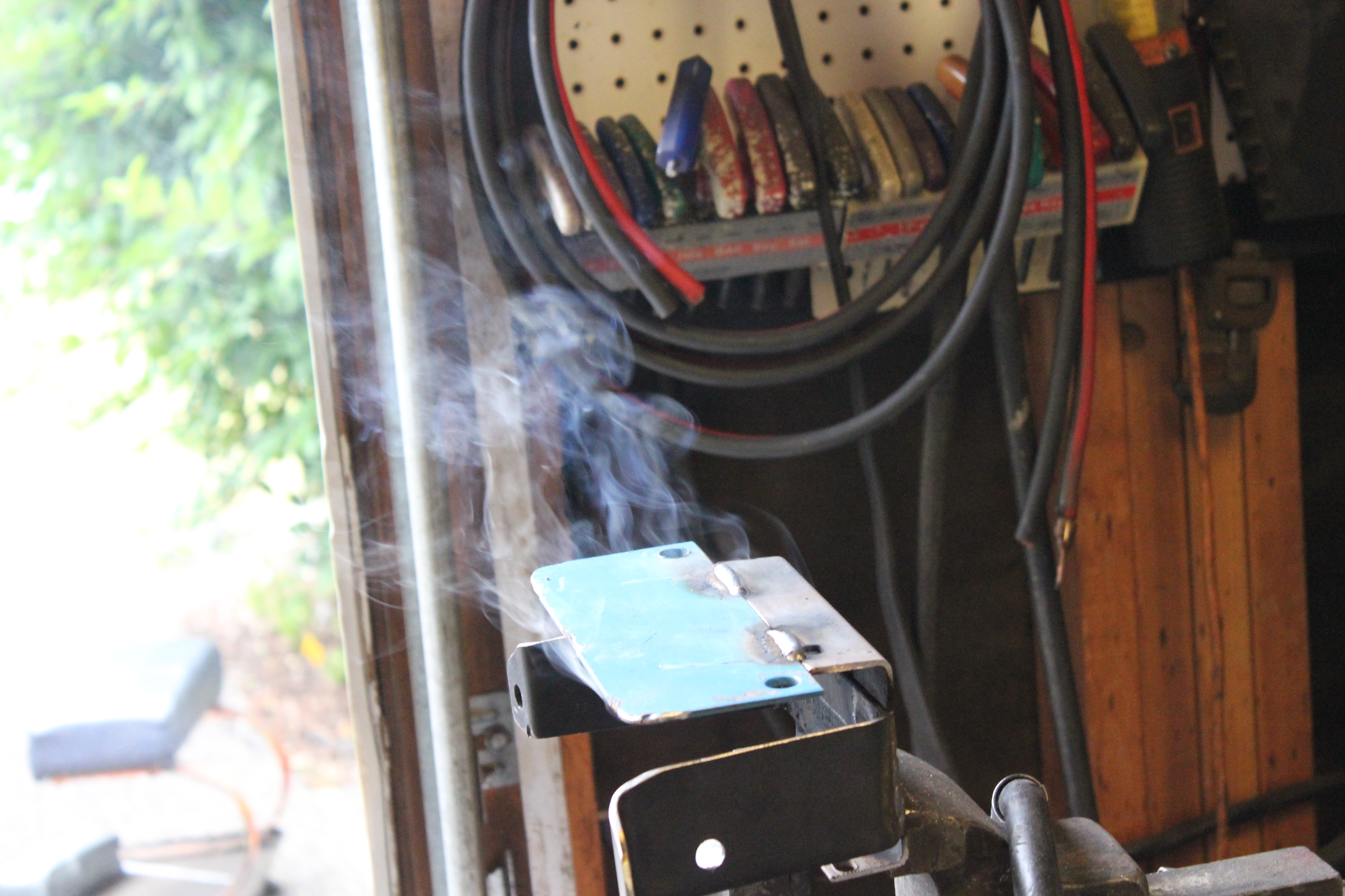

    Welding on patch plates on the exhaust.... It's got a bad case of rot.
    Battery tray...smokin'

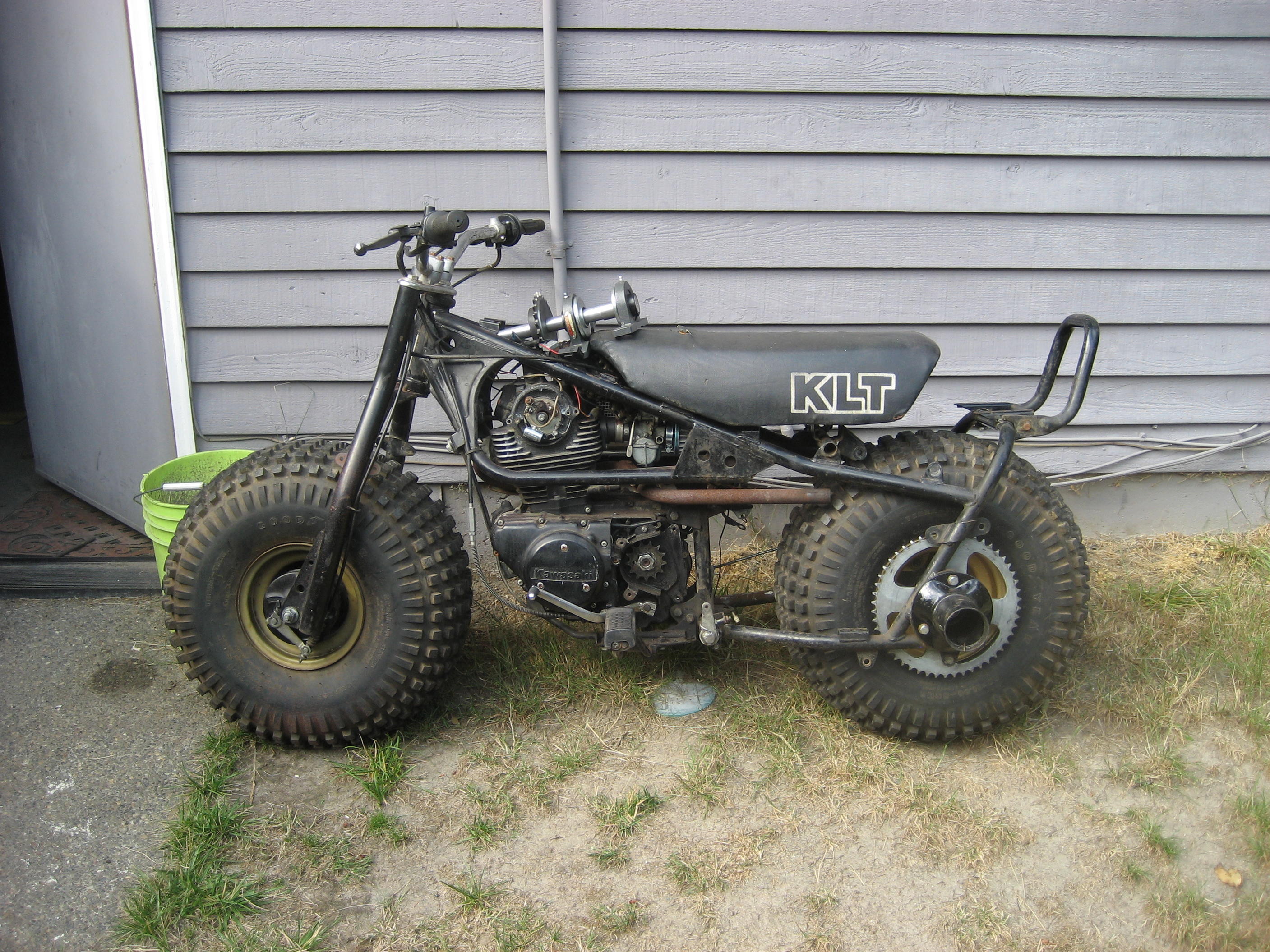

    It's rideable! Little tweaks here and there will be surely necessary, but it's together at least!
    Oh, and the kickstart you see on the parts diagrams for the KLT200 is seriously exactly what you see in the pictures. I figured it was an unfinished illustration that accidentally got released as is. Nope. It's actually an emergency - dead battery - kick start lever that has to be slid off the splines after it's fired up. I found an NOS kicker online, bought it and was surprised $40 later. Oh well, my fault. I modified it to work with some streetbike kick start lever I had in a box of parts, and it came out looking like a factory part. Almost. At least it's a clean modification. Not sure why Kawasaki didn't come out with a legit kick start option.

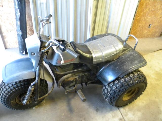

    I need one of those spark plug boots.
    The 200c does have a suspended front end. Looking at it, it's odd. ...Almost like Kawasaki just rigged something up and got rid of it! lol
ID:	233510Click image for larger version.

    It's not odd it's called a leading link and it's quite common amongst European bikes. It works great.
    May 2010
    Wichita, Kansas
    1,361
    I agree, it does work pretty good. Glad to know what it's called.
    I'll still call it odd.
    I just wanna go fast. If your not first, your last!!
    Reproducing the Tecate CDI. Contact me if you need one. I'm most accessible on FaceBook. You can find me on the 1984-1987 Kawasaki Tecate KXT250 Group.
