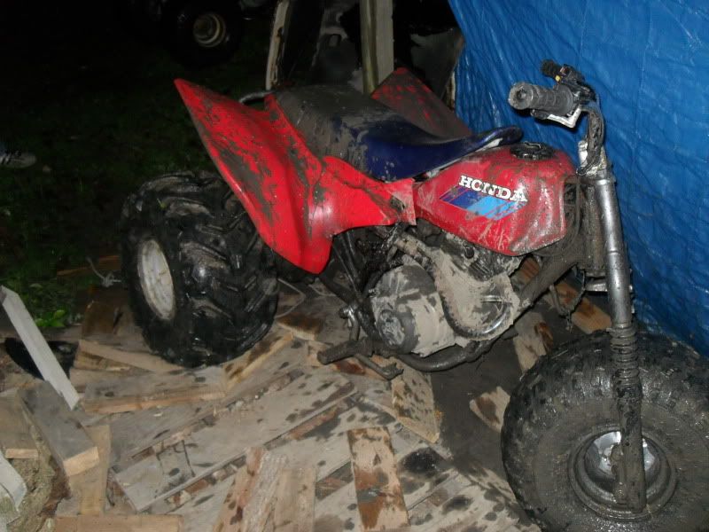

    We used thread lock in between there, and it seems to work. We fired them up, and rode them around my little track that was all muddy. These things really bog down in just a few inches of water. I need to look into switching my front tire out, it liked to just push in the turns with the slippery mud.
    Heres a pic of mine

    I just put the front end on this week. It had a honda cl100 motorcycle front end on it, that was only good for wheelies
