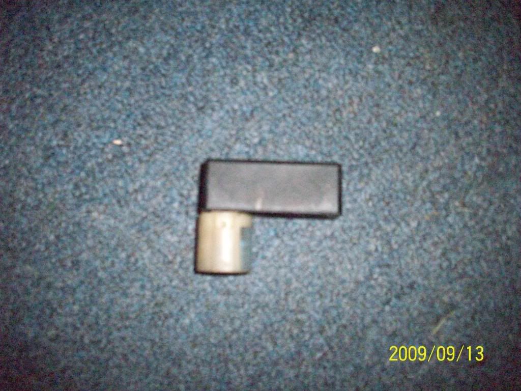

    alright so i put on the good stator and have strong current coming out of that. but we took a test light to it and we are getting alot of juice into this box and practically nothing coming out? so could this little box be bad and if it is can i get another one? also what does it even do? lol

    That is your CDI box, and it can be tested using OHMS. I had the same problem you described above, and it turned out to be my ignition coil (going to spark plug) The ignition coil can also be checked using OHMS, or if you have another one laying around you could swap it out real quick and see what happens. I used a ignition coil off a 185, and im sure the 200s ones will work good too if you have one. I still run it with the 185 coil, the numbers are slightly different on the coil, but it works perfectly, and I havnt had any issues in the last few months. Good luck!
    Here is the manual link. http://72.52.143.80/~trikes/ Find the OHM test for both the ign. coil and CDI box. Let us know what you find. Good luck.

    alright well i checked the coil and that seems to check out with the multimeter. so im thinking its the cdi box. im not quite sure how toi check it and i dont have a spare laying around. so i guess ill try and get one through the classifieds here or something. unless theres a diagram that shows the round plug cdi's and not the 2 square ones that the 83's had

    i check everything with a multimeter except the cdi boc..and everything else checked out good. so im just gonna try and get a new cdi box and go from there

    i cant seem to figure out how i would do so? i looked at the diagram and that showed me how to test everything else but the cdi they showed had 2 square things instead of the round one that i have.
