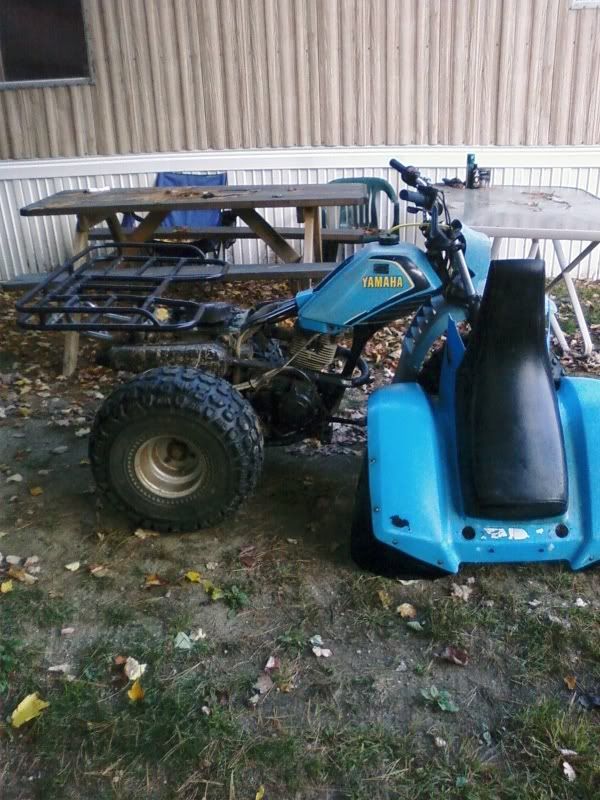

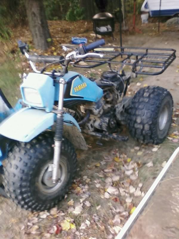

    Never had a yamaha before, but here's what i got. Anyhow, seat is perfect, plastic all there but faded, good tires on it, and everything is rust free. Starts first pull, but smokes some..I think that's valve seals. The motor has a knock though. Gets faster as RPS's increase. Thought the clutch was slipping some, but the adjustment seemed to help. Any thoughts about what would cause a motor knock? Oil is overfull a bit also.. Any way this would cause smoke also? Paid 200 bucks for it, and took the pull sart off to make sure that wasn't the noise.

    here are a couple of poor pics..
