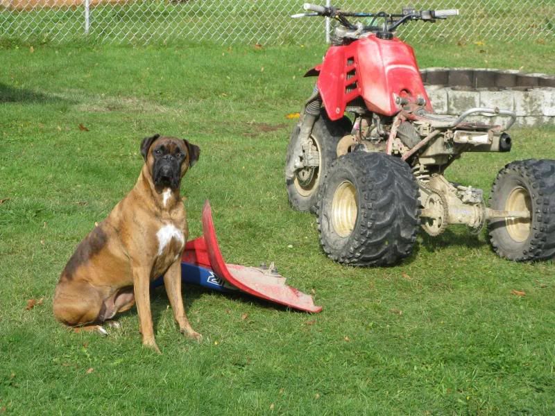

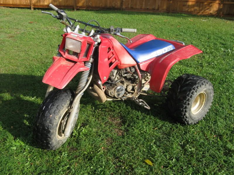

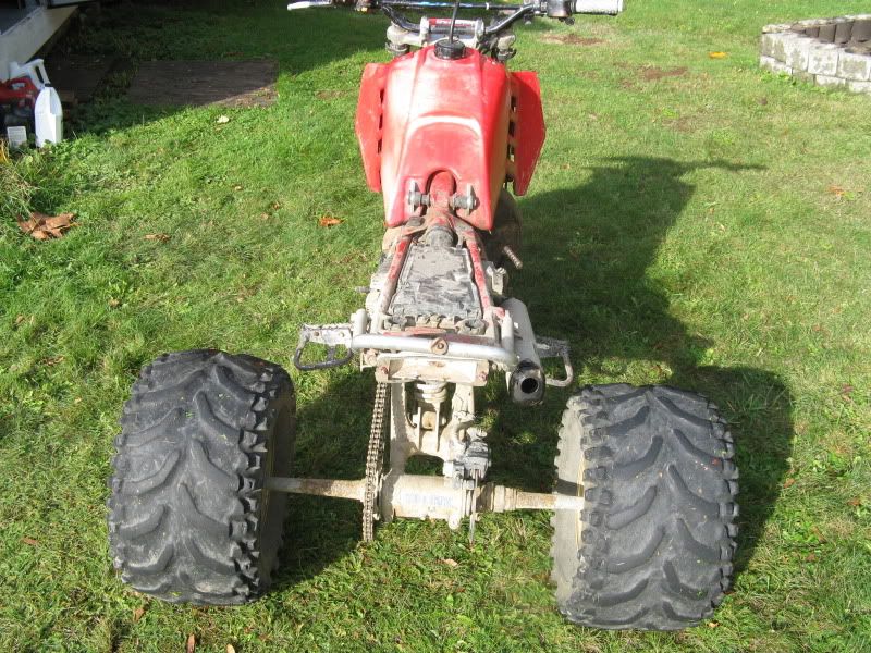

    The only pics I have so far are the ones from the day I brought it home, looking like a turd I dont think the previous owner was big on cleaning it, but belived in riding it hard....anyways here are some pics.

    nice! yea the 85-86 250R and up are 25 splinned axles, where is nearly every other honda made is 24 splined, I think but dont quote me g-force makes extended hubs for that spline, those coupled with some higher offset wheels will widen it up greatly, dont make it too wide otherwise you might get stuck in a tight trail with it!
