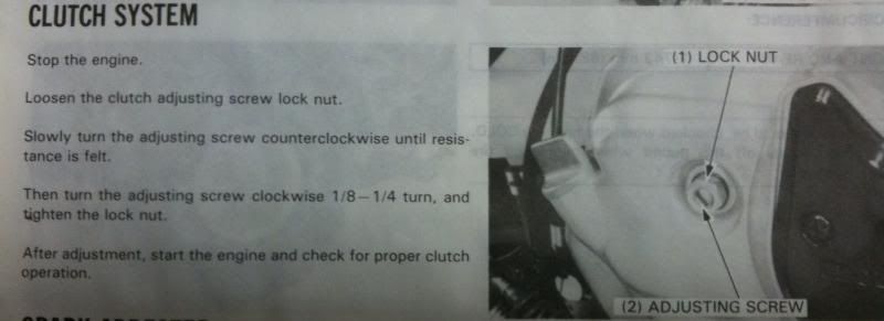

    From the Clymer manual.

    you need to adjust the clutch when you rev it up in neutral and shift up and it doesnt wheelie

    I have the 86 ATC125M FSM and it also says the same thing, but between the Clymer manual and the FSM, I still do not really understand when the clutch needs to be adjusted.
    I figured I would go ahead and loosen the bolt, then turn the screw counter-clockwise until I felt resistance and then turn in 1/8~1/4 turn.
    Problem. I turn the bolt, and then entire thing turns (the screw in the center and the bolt)
    Any idea how to loosen the bolt? I did not think it would be that hard! I tried taking a 14mm open wrench and a flat head screw driver and while holding the screw with the flat head screw driver, loosen the bolt, but I can not. (the bolt is 14mm and the adjustment screw is flat head)
    Any advice?
    Thanks!

    to loosen the bolt put a flat head in the screw and hold it while you loosen the nut on the screw... then do your adjusting.. then you need to hold the screw where i needs to be and tighten the bolt and try to keep from moving the screw when retighting the bolt so you don't loose your adjustment.

    use the back of a wrench, that way you can hold the adjusting screw with a flat head screwdriver. to make it easier, when you have the screw adjusted, make a mark on the side where the slot lines up. this way when tightening it, you can check if it goes out of line.
