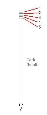

    According to my picture
    What is "move it down". You mean move the clip down (to #4), right, not move the clip up (#2) what would move the needle down. Always confusing
    By moving the clip down, it moves the needle up what in turn makes it run richer. Is that a correct statement?

    Needle up=richer, lets more fuel in.....Beets

    My intention was to go down, as in try #4 and then #5
