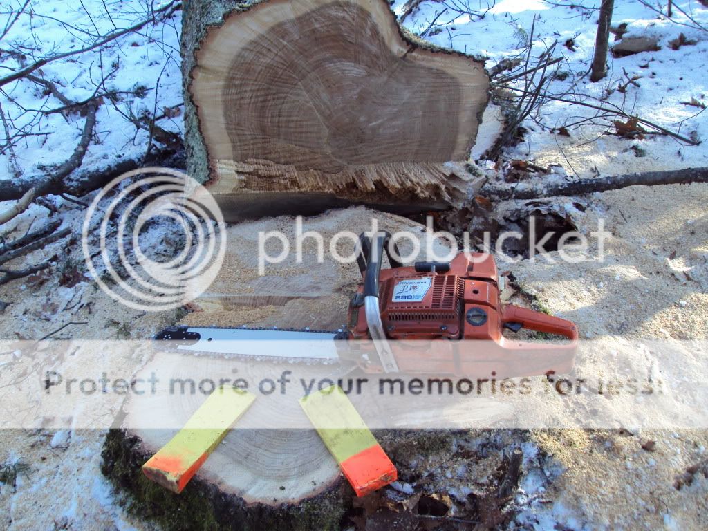

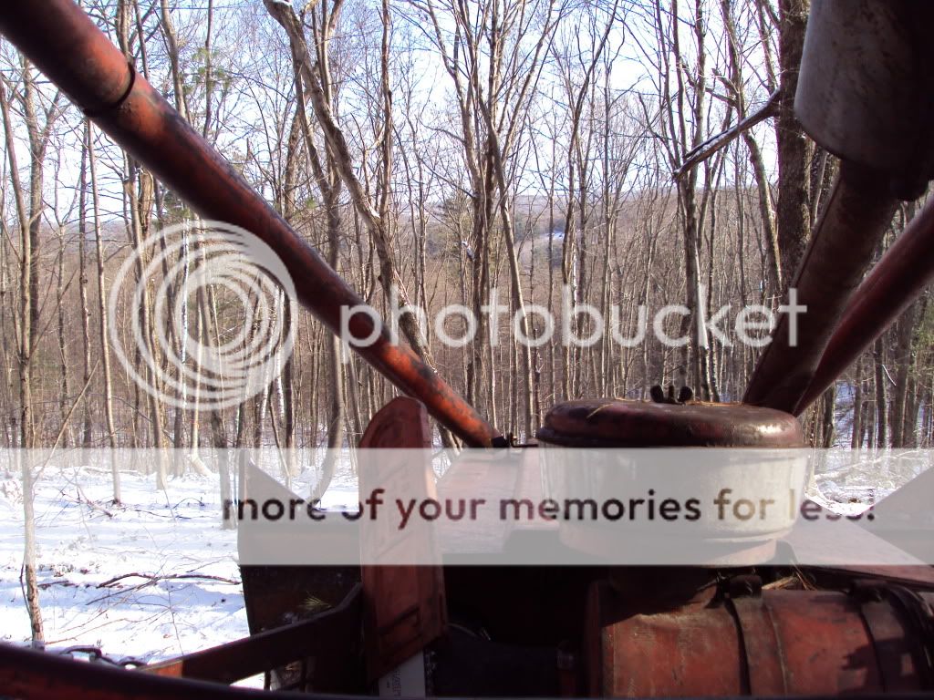

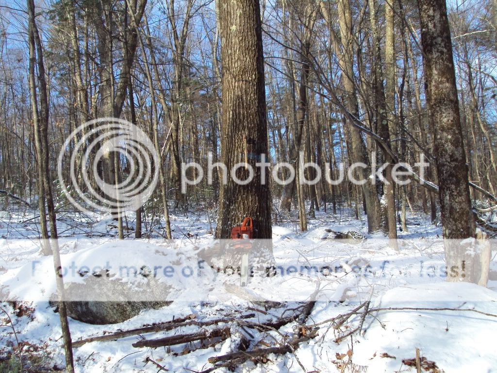

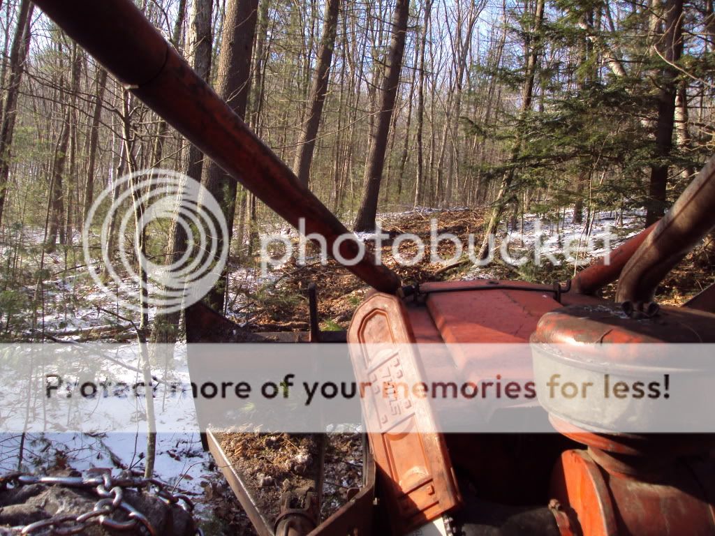

    Took a few pics of my new "office" The lot is only 25 or so acres and will only take a month or so to do, but its covered with alot of monster red oak. Figured a few of you could enjoy this,......

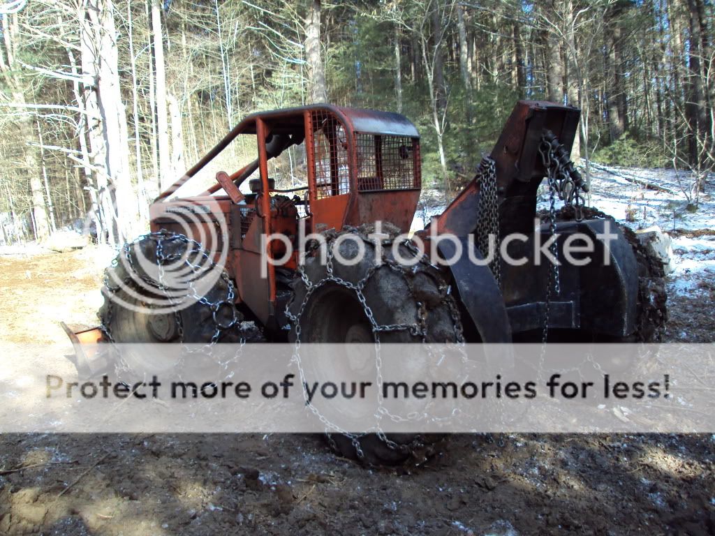

    Heck of a set of tire chains on that machine.

    Nice XP ....how old's that?

    the 288 is showin its age, but still runs strong. I personally like stihls better, my ported out 066 will be back together by this weekend and will spank the huskys arse ten fold. The new chains on the rear are pretty meaty, just gotta be careful with the throttle,.....easy way to snap axles.

    screw burnign the rea doak sellthe logs burn the rest, and nice 288 and i was always a stihl man but i love my 385xp just heavy to carry all day. and thats perfection cuttign the rakers i take 2 passes off a brand new chain lol

    Brapp, dont worry...the red oak sure as hell aint going into firewood, only the tops. Most of the butts are making veneer grade and is worth a pretty penny to the slicer mill. Also the 2nd, to 4th logs are making it into the grade markets.

    those tires! wow!
