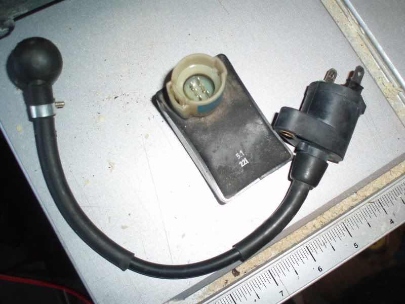

    Thanks, that would make sense, here:
    Now my problem, isn't this supposed to be the CDI I use with this 85 motor?
    http://cgi.ebay.com/ebaymotors/New-H...Q5fAccessories

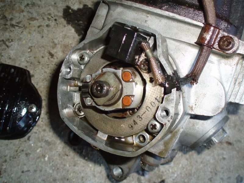

    I have an identical spare one, but my motor's CDI is enclosed, here's the inside:
    Any ideas?

    The term "CDI" is the type of ignition system.
    The second pic is the pulse generator (#2) and the spark advancer (#1).
    http://www.xtremeusa.com/fiche_secti...1985&fveh=2784
    The third pic is the ignition module (#5).
