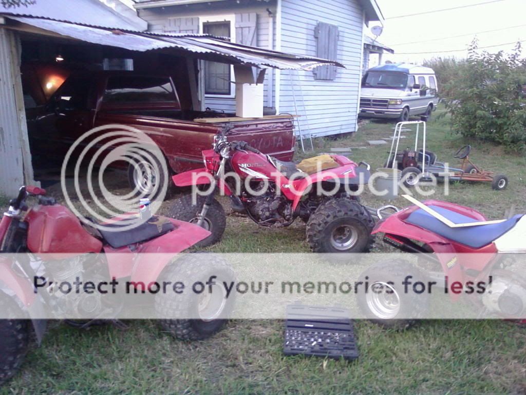

    most are the parts are interchangable, i got 4 bikes now and counting
