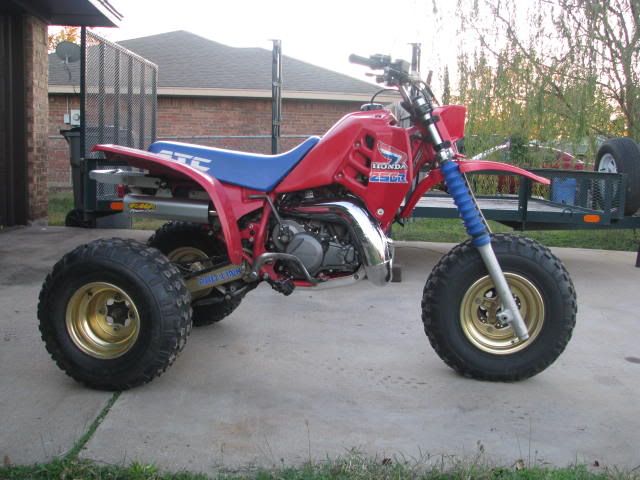

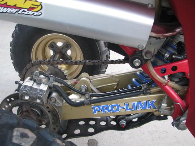

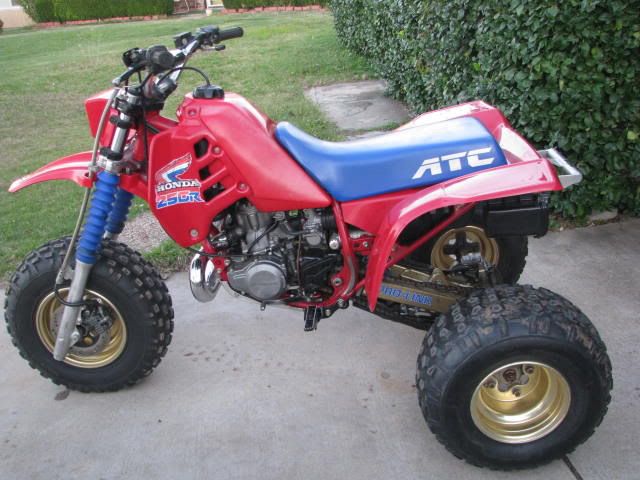

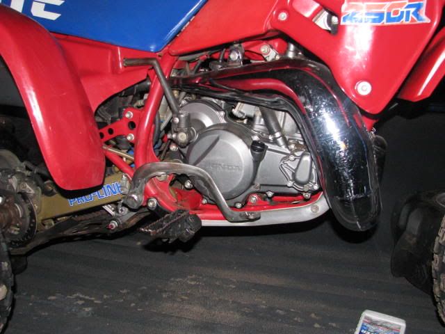

    Hey guys I bought this 86R. I'll be able to see it in 19 days when I get back home from Iraq. I got a killer deal on a CT310 kit, so I bought that too. This will be the first time I've owned or ridden a 3rd gen R. I have a question though. What is a good pipe/silencer combo for this setup? As you can see it has a brand new FMF system on it. But reading through some of the threads I keep hearing not so flattering things about them. The 310 kit is a mid-top port set-up and I would like to get a pipe to match this. What would be a good candidate? Or will the FMF work fine? Thanks guys!!

    well first off, thankyou for doing whatever your doing in Iraq to serve our country. man she is sooo clean!!!! congrats

    such a nice bike. Glad to hear you finally got one. fmf pipe should work fine.

    FMF makes a decent 250r pipe. For a big bore though, I think a ESR or Paul Turner high rev would be a better choice. Depends on you though. What kind of riding you plan to do, what kind of rider are you, where do you want the power, etc. Ifyou just want a top end screamer, get the PT. ESR seems to have a wider powerband. FMF's are very mid rangey (in my experience).

    Nice score! Looks really nice.

    Looks VERY nice and original! Do you plan on attending the Rampage again next month? Be great to see it in person.

    I would just stay with the FMF. The one you have is paid for and its in nice shape. I had a FMF on my 310. Great low-mid range pipe. If you looking for topend. You should look into something else. I mainly trail rode, and the FMF worked great.

    Ok don't forget to up-grade your Carb ( 38mm or 39mm ) also make sure your Reed's are good or you can up-grade those too.
    If your going to ride trails than the FMF pipe will do, Now if your riding Dunes or Drags than - Paul Tuner or ESR Pipes would be BEST.
    Quick Note ~ The Front Brake Line is NOT routed correctly ( the Lower Brake Line needs to go on the IN side ) Should be a Quick Fix.
