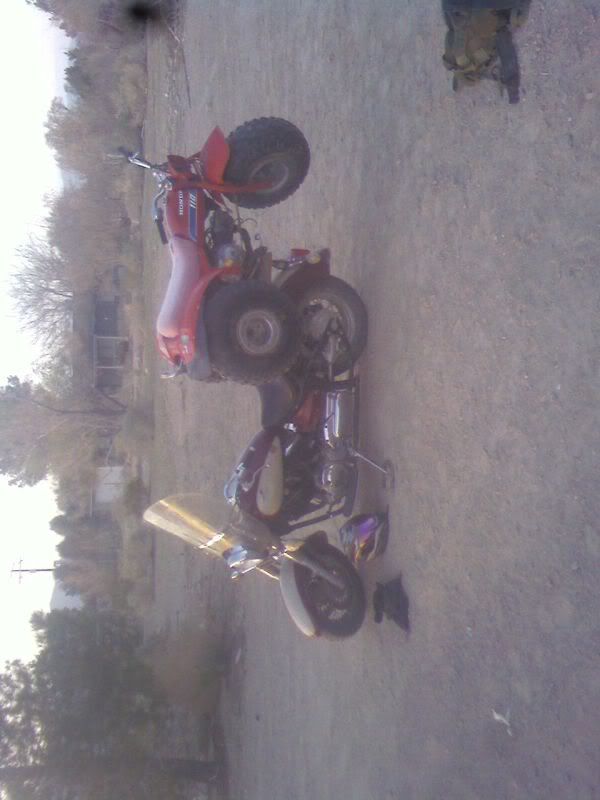

    I purchased a Honda ATC 110 today for $35. (It won't stay running, easy fix) Any idea what year this ATC is?
    And yes, I made it all the way home, although the bike was a little difficult to steer. (The ATC was tied down) I took all dirt roads home with some connecting pavement.

    OH SHT that is wild. Thats the best tow-rigg I've seen in a long time. Thats a nice looking 110 there. you gotta post that pic in trikesylvaina
    tundrawolf is offline At The Back Of The Pack Arm chair racerFirst time rider
    High desert, CA
    176
    Thanks! I was stoked that it worked. The bike is all I have, so I have to make it work. I custom welded an ultra heavy duty rack on the back of it (It is a 2002 V Star 1100) with a 3/4" piece of plywood on it. The engine on the 110 looks brand new. It's amazing to me what condition it is in. I am going to take the carb off and clean it out. The tank has a LOT of rust in it. I am thinking nuts and bolts and a lot of shaking.

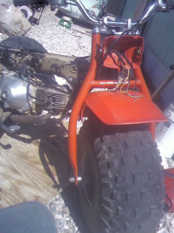

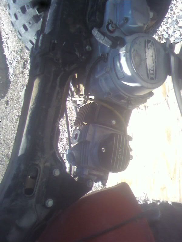

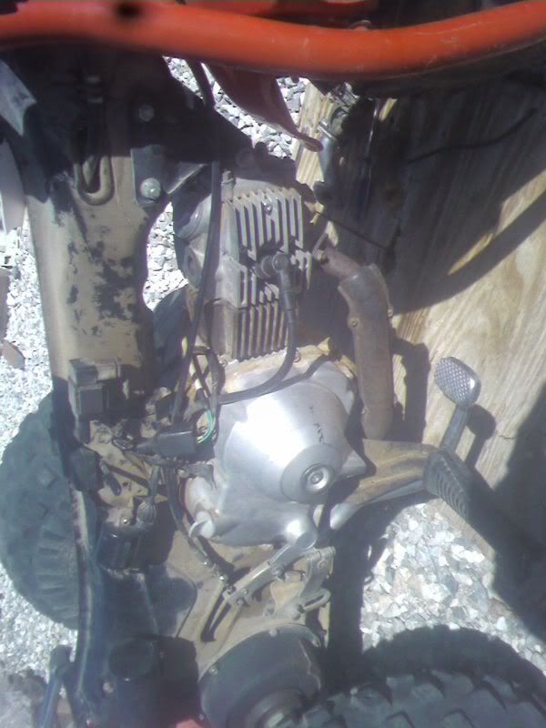

    You know what the problem was? The needle valve was installed upside-down. Yes, upside-down. Not only that, but the rubber portion was chewed up. So, the spring loaded portion was shoving the valve shut at all times. The guy needed gas money-what can I say? How do I tell what year it is? Here are some more pics:

    ive never heard of anyone installing a needle valve upside down
    Crest California
    3,014
    Needle valve was installed upsidown? That's a first for me..
    It should say what year it is somewhere on the chassis, unless the sticker was removed..??
