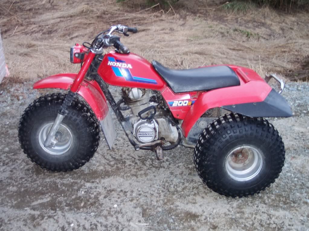

    So what have you done and lets see some pics. This came up again this weekend, MonroeMike likes to keep reminding me of it... so Mike here is that pic again.
    The "Gatorade" Gas Tank and "Snap On" Pull start
    I have since fixed the gas tank and she starts on the first pull so I dont need the extension on the handle LMAO

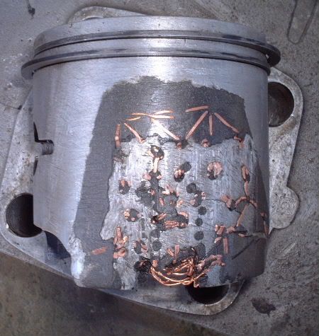

    I've taken a seized piston and cylinder, sanded the high places off the piston, cleaned/cleared the ring grooves, and used acid to clean the aluminum off of the steel sleeve. Put it back together and ran it.
