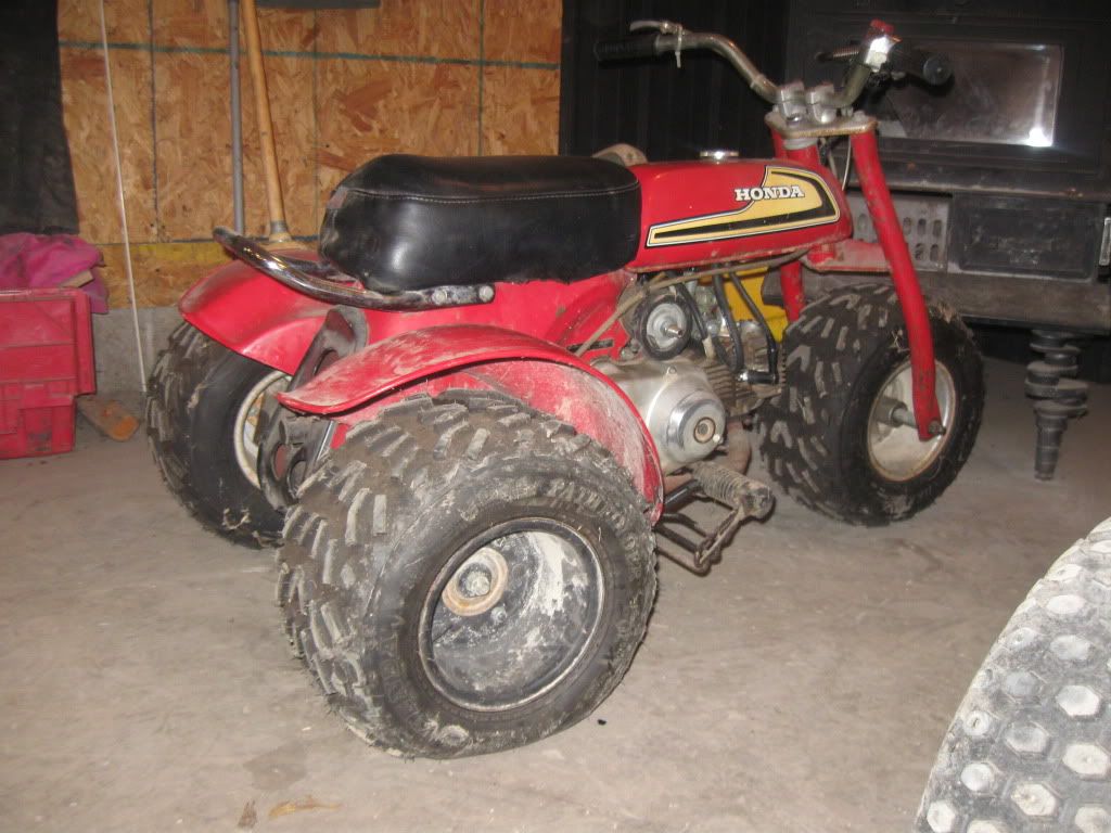

    I had a guy give me a 1974 honda atc 70 it runs but very badly the guy that gave it to me said he thought somebody had drilled the jets out and screwed it all up!My question is where do I get parts for this?Everything I have found is for the 78 and later models and from what I can find is the carbs and intake are different?Can somebody clarify this for me?would really like to get this running but dont want to buy the wrong parts.Other thanb the carb its in excellent condition for its age!!heres a few pics

    dratv.com ebay sterdyproducts.com . a lot of times rust or dirt can get into these carbs form the gas tank and make it a real pain. if the jets were drilled i would just start fresh with a new carb . i picked one up on ebay brand new for around 35 bucks and mines running great .
    PS year to year the atc70 engine are pretty much identical when buying parts.

    Ebay is an alternative as well... get a carb rebuild kit... that 70 is in nice shape. Welcome to the boards too...

    The rebuild kits are different from 74 to 78,78 has a round bowl on the carb and mine has the square problem is I cant find a rebuild kit for mine?
