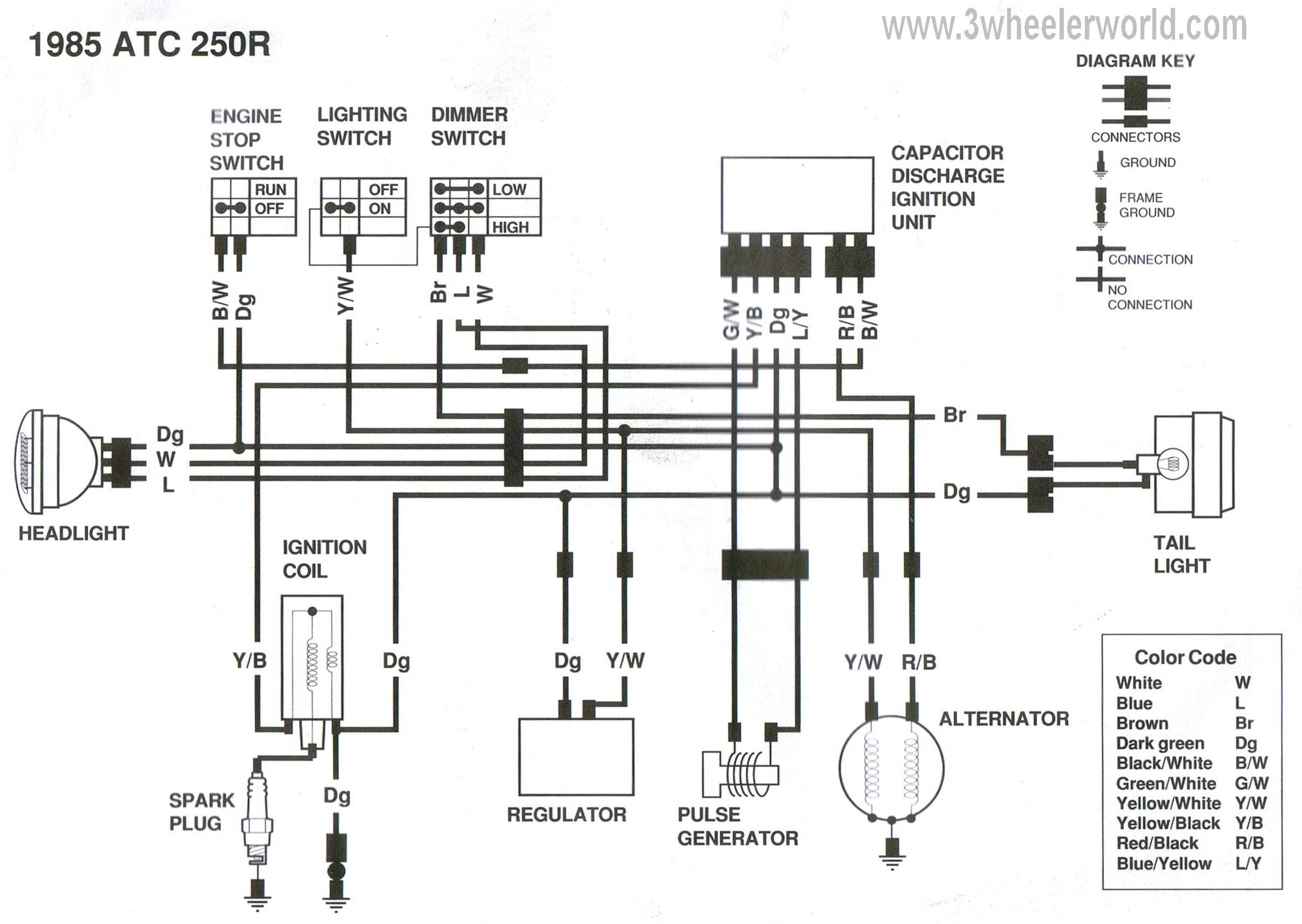

    im trying to splice in a universal headlight/kill switch cause the old one is broke and im cheap lol. if someone has a diagram of those wires or can give me a description of the wires and colors it would be much appreciated. thanks in advance

    sorry thought the post included all that. im on a 85 atc250r
