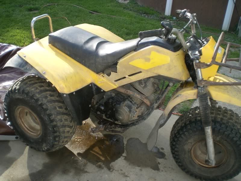

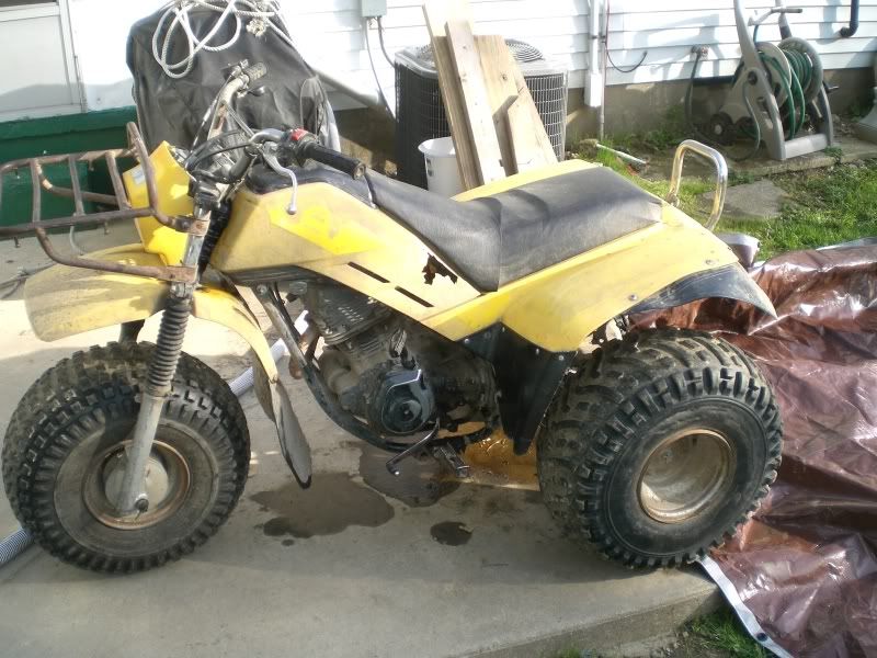

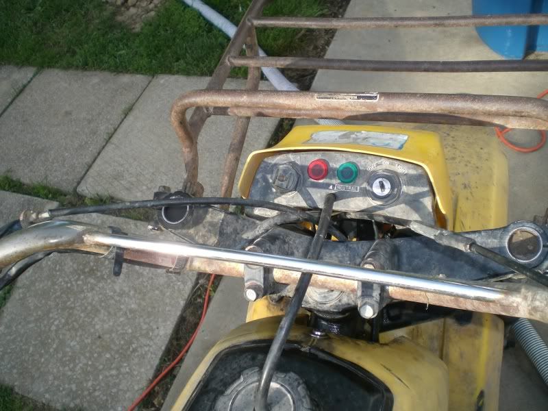

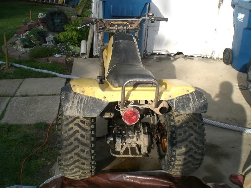

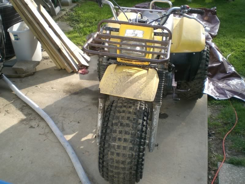

    http://img.photobucket.com/albums/v6...5/CIMG0494.jpg
    Not bad for $300. I looked on the front of the frame, right behind the headlight, the only numbers I can get off that are YAM29V0223

    ok i just found what looks like it says JY329UU07F0104838 that is the best I can see/guess of what it says lol, there is a tag that says its a 1985

    It is a 1985 225 dx, and from what I can tell the bracket for the headlight was replaced which is why there is a red light. Also your tail light is not original and it looks like the grab bar is bent up some. The best bet for the tank plastics is ebay, and the petcock valve I would go to a dealer for it should come in a kit for about 15$ new. You might even want to check out the seat covers on ebay, as that one doesn't fit quite right and some of them look really awesome for decent prices. Just saw something else too the headlight plastic is off of a 200, the 225 has a grill on each side.

    ok thank you so much for the help, ateast I know what I got now lol. I think it was a good buy for $300. Ya I knew the fender was not original, he gave me the original one with it, and new set of brakes, front forks, and a spare front tire and wheel. Thanks again for all the help everybody. You have no idea how much I appreciate it.

    I have a spare side tank cover, only one side but it is yellow and would match. I think it is the passenger side.
    If you do decide to replace the seat cover, i would gladly take yours since I'm out of work and can't afford much stuff to pretty up my YTM225.
    Looking good though for 300 bux considering its got a full suspension. Might not be a 200x but it is still worth it. I have 2 of them, a blue and a yellow YTM225dx.
