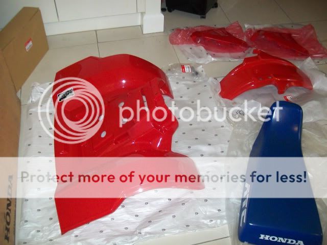

    I think I might have just stole a NOS rear fender for $475 off of ebay. I hope its as nice as he says it is. Never mounted but has been sitting in an attic for some years. We'll see.

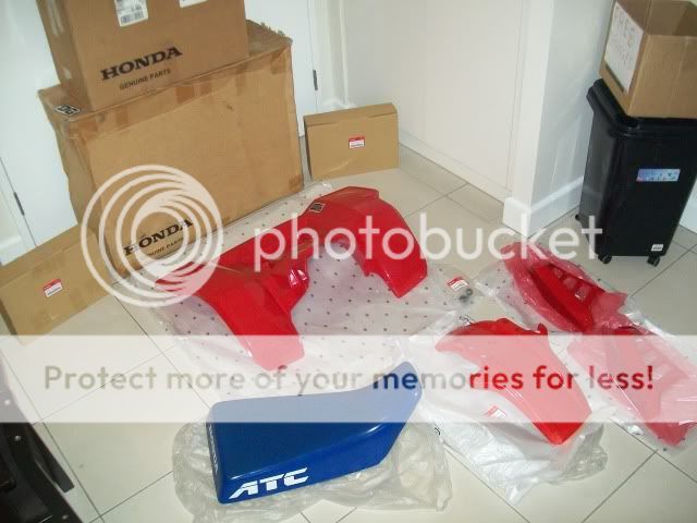

    Im picking up the tank and right shroud tomorrow.
    Now all i need is...... EVERYTHING ELSE! lol

    Holy Score of NOS parts, JOB WELL DONE!!!! Is the tank NOS as well?? I would love to see pics if it is!! Thanks for the compliments and back at you, your air cooled project is top shelf!!! I can't wait to see this 3rd gen R resto!!!

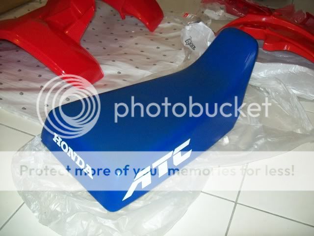

    Nice job. I would love to have that seat.
    Cheers. Settle for a pic?

    I'm happy for you that's for sure. I loved your Air Cooled build and I'm sure your Liquid R will be even more stunning. Cheers Mate!!!

    Definitely scored on the seat and plastics.
