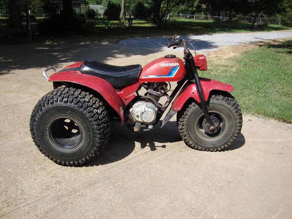

    What year and model is this?
    82 atc110
    82 atc200
    83 atc185s
    Whats old is new.

    1981 Honda ATC 185 I believe.

    Tank decal is an '83. The rest of the trike I have no idea.

    Is there anything specific to help identify besides the V.I.N which I am trying to search ? I'm not sure if its a parts bike or what. The owner claimed it was a "bored out" 185 but the code on the jug looks like its a 200 cylinder. The rear end has two different type hubs. He claimed it was an 85 but it can't be because it has no suspension.

    Its a frankentrike!
    Mexico
    9,018
    Looks like an 83 185S with weird rear rims.

    He's right....its a mutt. It could be a 80' 185 (it has a trunk), plastics look painted over, 83' 185s gas tank. Tho has a 200 cyl.? Hard to tell at this point.

    more than likely i'm probibly wrong here, but the outline of the rear hubs remind me of kawi hubs.

    I'm rooting with 81 200, that's has other parts could be a 185, definitely not an 83 185's though El Camexican, has no suspension on front and has a trunk doesn't match up. check the backside and bottom of the cylinder if it says I think it's 182, then it's a 185, but if it says 193cm then it's a 200 but is definitely earlier than 83 model

    Im going with the 81 atc 185!!

    81'-83' 185s has no trunk...

    I'm pretty sure the code on the bottom of the cylinder says 193. Is there a place to run the engine serial number to make sure its not a 200 top end on a 185 bottom end if that is even possible. It could be a complete motor swap. I am going to have to make sure it is the correct carb/jets for whatever it is.

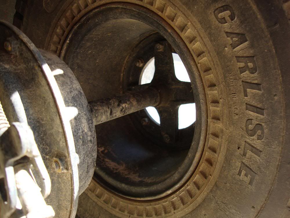

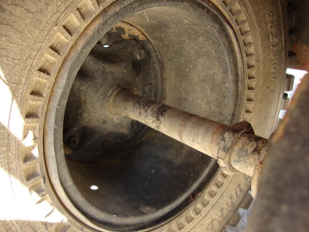

    I'm trying to figure out what frame it basically is so I can find a set of fenders. I am going to have to get the correct hubs and new rims also. It looks like someone drilled a hole in the rims for the tire tube stems. Are these supposed to be tubeless and what is that large nut in the middle of my axle?

    that nut is the axle nut. there are two of 'em and that is not where where its supposed to be!

    isn't it a large frame Honda? looks to big to be a 185s

    I'm thinking its a large frame but have never had a small frame to compare to. Didn't they make a larger 185 for a couple years that wasn't an S model?
