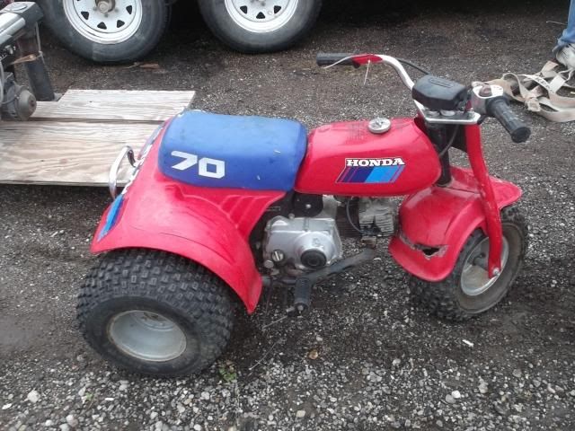

    My $250 ATC70 why is fender rubbing on motor?
    Haven't picked it up yet, but why would the fender be rubbing the engine?

    forks are bent or its the wrong fender

    i may b wrong but im pretty sure it means the frame is bent under the gas tank

    From some of the other pics it looks like the fork is bent

    Hope the forks are just bent, think i paid a little to much if the frame is bent. But i know people and could have a straightened and gusseted if needed.

    Quote Originally Posted by Canyon Man View Post
    same thing I noticed.
    no biggie though, there are some cheap forks for it on ebay that are not bent.

    Yea i seen they are like $40, that would be nice

    Quote Originally Posted by booblinker View Post
    Read this.

    Fixing a bent frame isnt that hard either. Most of the 70's have either a bent frame or forks. There isnt much support on them.

    Monroe Mike, thx you very much. One of my 70's just developed this problem. I don't have a bottle Jack but I am sure I can make the axle Jack off my full size blazer do the same.

    I use a scissor jack and a piece of 1x4 wood straight off the top of the motor , base of the jack on the head and let the scissor ride on the forks . Remove the front tire and fender and jack till its straight . The fender will have about a 1/2" clearance from the head when it's straight again .

    The one I bought has a worn through front fender too! I had no idea that meant bent forks! That really sucks the bag.

    Well this deal wasn't as good as I though, bent frame, and I'm a moron and typed byron instead of byron center, that about doubles my mileage, plus ill have to get a motel, after tax, auction fees, price of trike, gas, and hotel I'm going to have like 425-450 into it.
