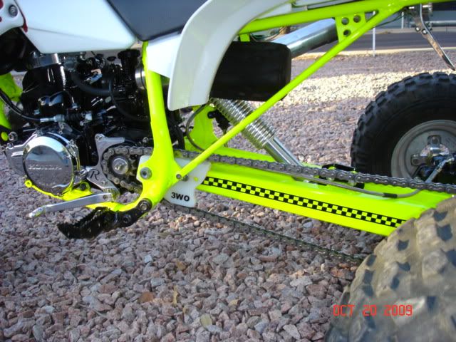

    CAUTION: if you plan on a marvin shaw,,,,, i am running a couple of them,, we have a 85 cu ft nitrogen bottle onboard to make adjustments easier.. if you go with the external spring model it will be almost the same diameter as stock,,,, they work great but i find i have to adjust it alot for different riders,,, primary rider on one is 140# so when i ride it i have to jack the pressure to 550psi from 300,,, so you might rethink it a little before spending the money,,, on the second note,,, i have a eliminator kit on several 250r's you have to dimple the tube to clear the frame to run naked!!!
