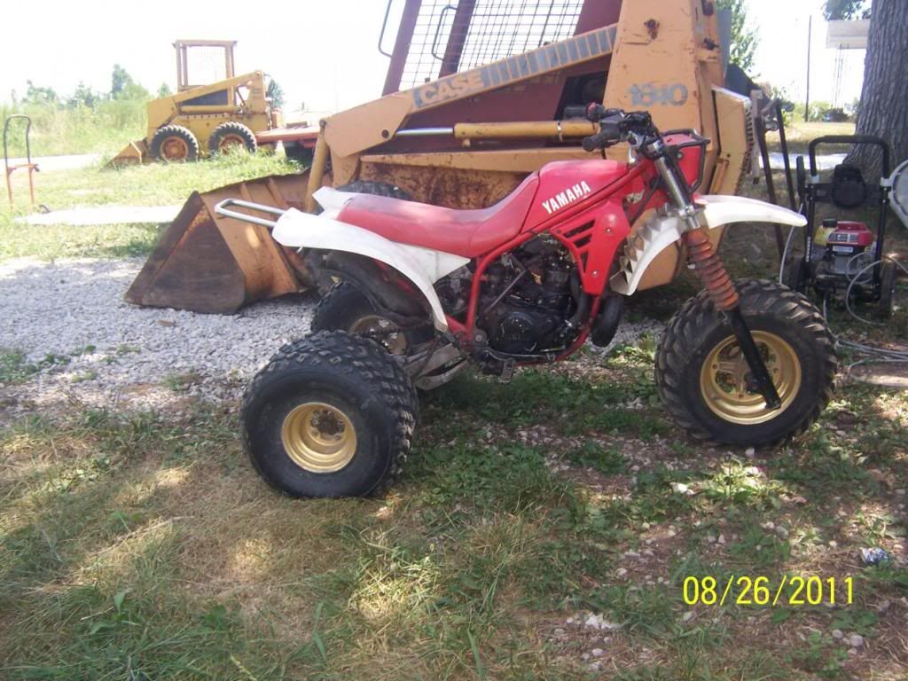

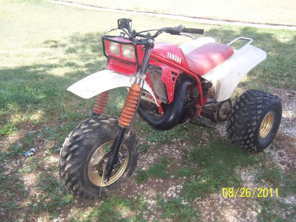

    Hello guys, new member here from fishkill new york ( upstate)
    I recently bought a 1986 tri-z 250 for 750 dollars. The guy delivered it to my house from Kentucky! I also bought a quadracer with a quadzilla motor in it from him.
    But anyways , this isnt my first 3 wheeler, i had a 125 honda with high and low range when i was 12. I also had a honda 200sx when i was 15. I am 25 now bte=p
    I found this site while googleing for parts and upgrades for my tri-z. As of right now the motor is .20 over, has stock everything except the dg exhuast. Also the exhuast is black not chrome ? Did someone paint it or did they come this way as well?
    Pictures are from previous owner. starts up 2-3 kicks. I am going to start taking her down to clean her up and give her a new paint job. Any suggestions on upgrades while its getting some love?

    the back end looks too high up, like someone shoehorned the wrong shock in there. i tried to put a blaster shock in mine, and that's how it looked. rode terrible and actually bent the shock. if it turns out to be wrong you're best bet's prolly a warrior shock...
    nice score though!!

    Yeah i was wondering if it was sapose to be sitting that tall in the ass end. I shall go to ebay and look for a decent used warrior shock. Do all years fit?

    as far as i know they do, the remote gas bottle mounts differently, but one can just strap it to the frame with a hose clamp. the only problem with ebay mono shocks is many seem to "need a recharge" which means they are pretty much junk. they can be rebuilt (i believe a member here does it, but not sure who), but i think that'll run about $150.
    if you're lucky you can find one used for about $50-100.
    also, there is a triz part interchange thread here somewhere you will likely find usefull.
    good luck with it, with proper maintenence they're great machines!
