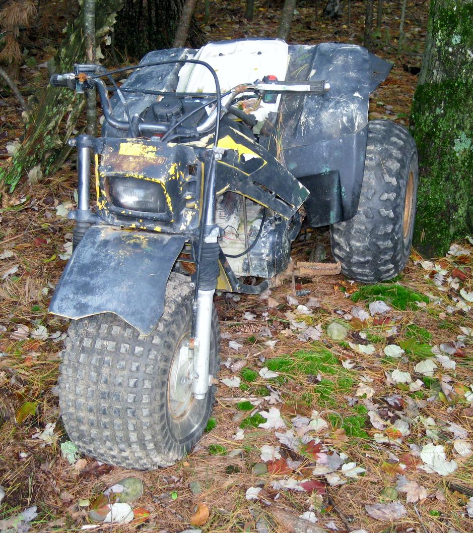

    Hi there. I have a beat up 225DX I am trying to bring back to life. When I got it all the hoses were off the carb. After giving it a good cleaning, painting the plastics, and replacing the seat and other missing parts, I put her back together, but am now trying to hook up the lines. There are 2 "ports" on the top side of the carb. I believe the larger one is to the gas tank. Any ideas where the other hose connects to from the carb???Click image for larger version.

    The hose from the smaller one runs up the frame, under the tank, it doesn't connect to anything (vent).
