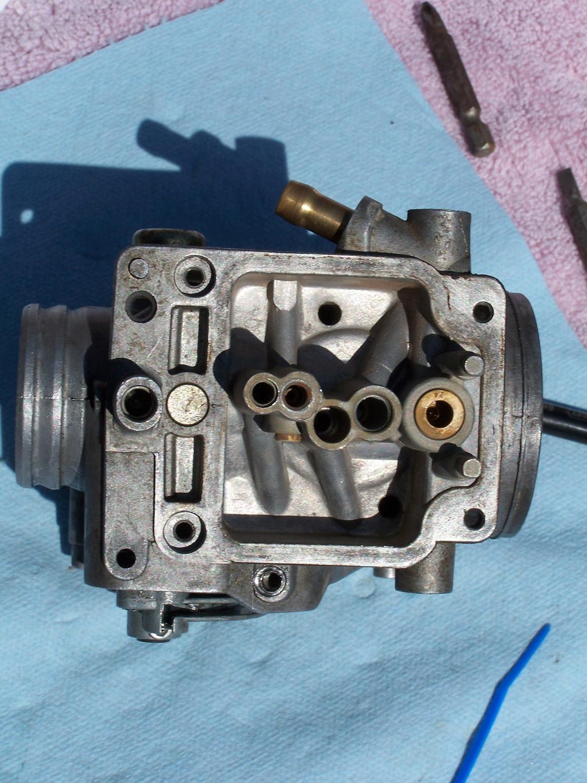

    New member here (just posted in new members area). I Just got my trike up and running and now I'm having an issue with WOT. It starts right up, has fresh gas, I rebuild the carb, idles fine, new vacuum lines. If I rev it up quick or ease into the throttle is seems to be ok but if I hit wide open and hold the engine will shutoff. It will sputter and pop if hit it Wide open quickly but if I hold it WOT it will die out.
    I just rebuilt the carb, got the idle set right, the idle mixer screw is set at 2.5 turns out. I'm wondering if I put the jets in the correct places as there are 2 jets thats will thread into the same places. The rebuid kit did not specify and online diagrams are not very clear. I'd really like to get this beast up an running. Any help would be appreciated! Thanks!
    Pacific NW
    4,255
    250??
    from float side
    is:
    float
    130 main
    38
    press in cold jet
    45
    pilot screw
    Now, under ONE of those suckers is an emulsion tube about
    an inch long prob full of muckrust too and it just sits in there.

    Thanks for that Pic and info! The rebuild kit I got came with everything short of one jet (I believe). It also came with a 1" brass looking tube thing That I could't figure out where it goes. I'm just trying to figure out if I got them in the right places. There were 2 that would interchange positions (one of which my rebuild kit did not include). As far as the Emulsion tube you are talking about, that's probably the piece I have left over that I can't locate. I'm going to pull the carb back off. Thanks
    Dec 2011
    Tabernacle, NJ
    10
    well I pulled the carb apart again i had the 130 main jet and the smaller jet at the opposite end reversed. Problem now is that smaller jet didnt come with my rebuild kit and it's plugged up so the trike wont start and idle anymore. I'm guessing I'll be ordering that jet seperately.. Is it a #45 jet? The one right below the rubber plug? It's so small i cant get compressed air to blow through it.

    Well guys just a quick update. I ordered the #42 jet that was plugged up and wasn't included in my kit. I put all the jets in the correct positions (pretty sure) and it fired up on the first kick. The trike idles well and rides around fine but if I try to mat the throttle it will get a stumble. I ried messing with the idle mixture screw but I can't get it to clear up. I can ride it around fine easing into the throttle. Plus the trike will run with the screw turned all the way in which I find odd. Other than that I gave it some fresh oil and its all back together. Any ideas!
