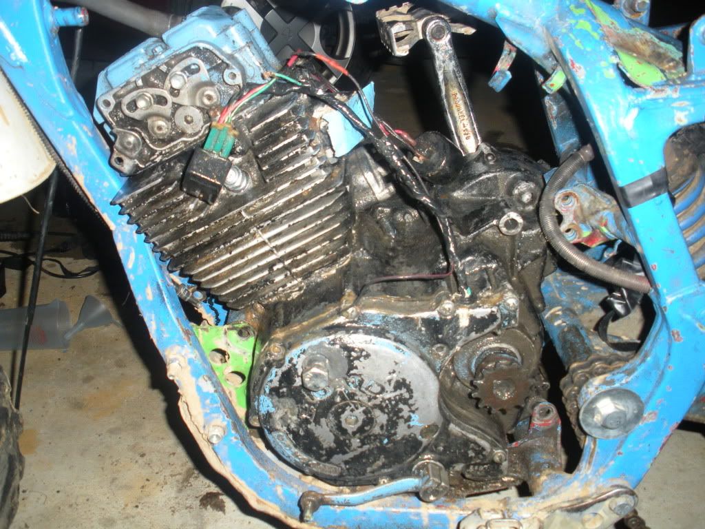

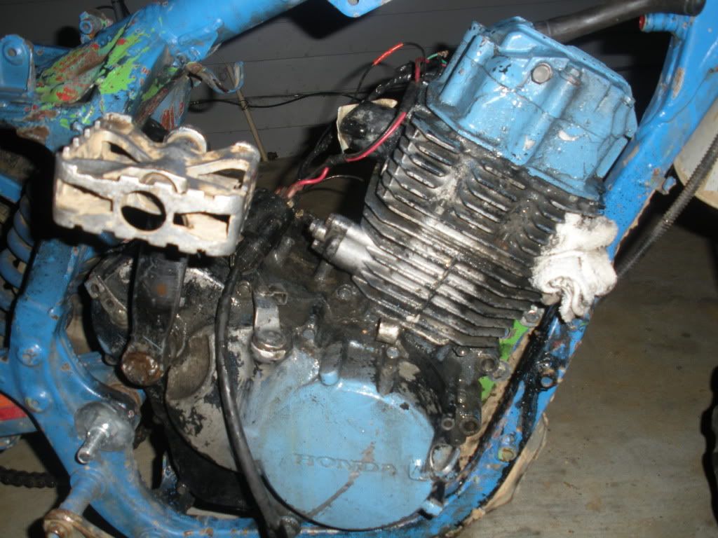

    i was hoping for a 200sx motor for electric start and reverse, my fiance is wanting to learn how to ride. i'll post a pic of what im working with 200x and you'll see what im talking about.
