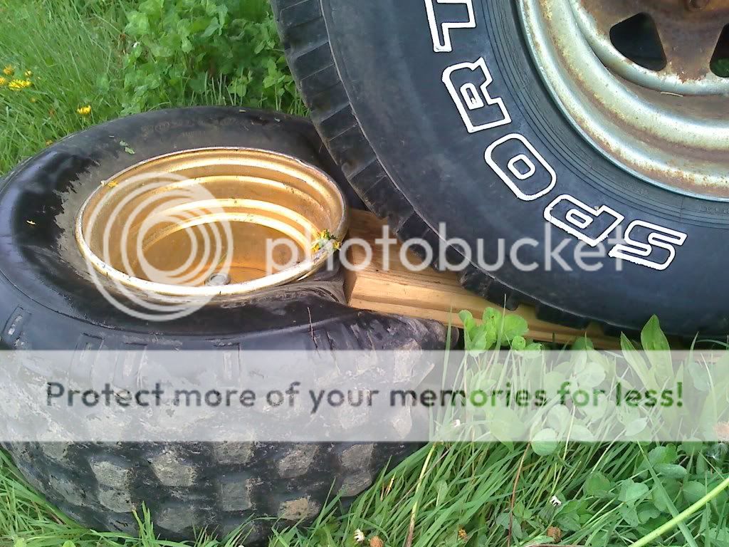

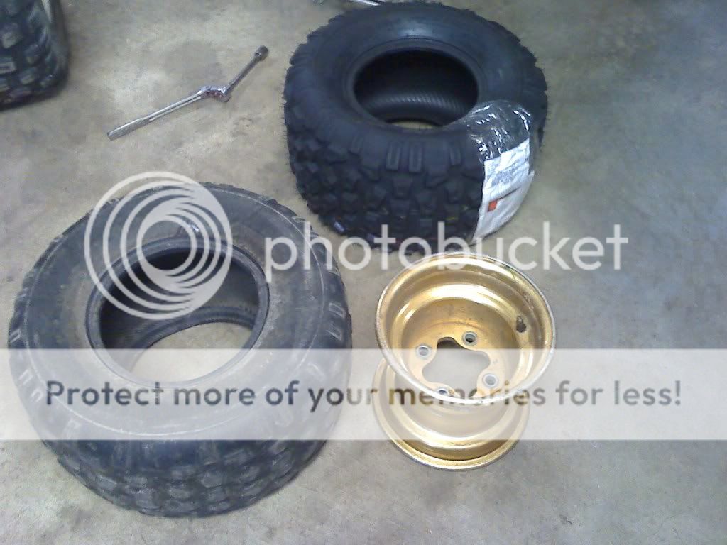

    I had messed with mounting and dismounting ATV tires in the past and found it to be nearly impossible. lol. My cousin has had them done at a local Honda dealer and AG / Truck tire shop and it took each place over an hour to do 2 tires!
    I decided to get some ideas from youtube and give it a try. It went great. It was well under an hour start to finish I can tell you that. I broke the beads by driving up on the tire with a truck, I still had to help them along with a rubber mallet, unreal. The tires easily dismounted with tire spoons and a rubber mallet, using soap and water for lubricant. They went back on super easy. I didn't even use any tools what so ever to mount the second one.
