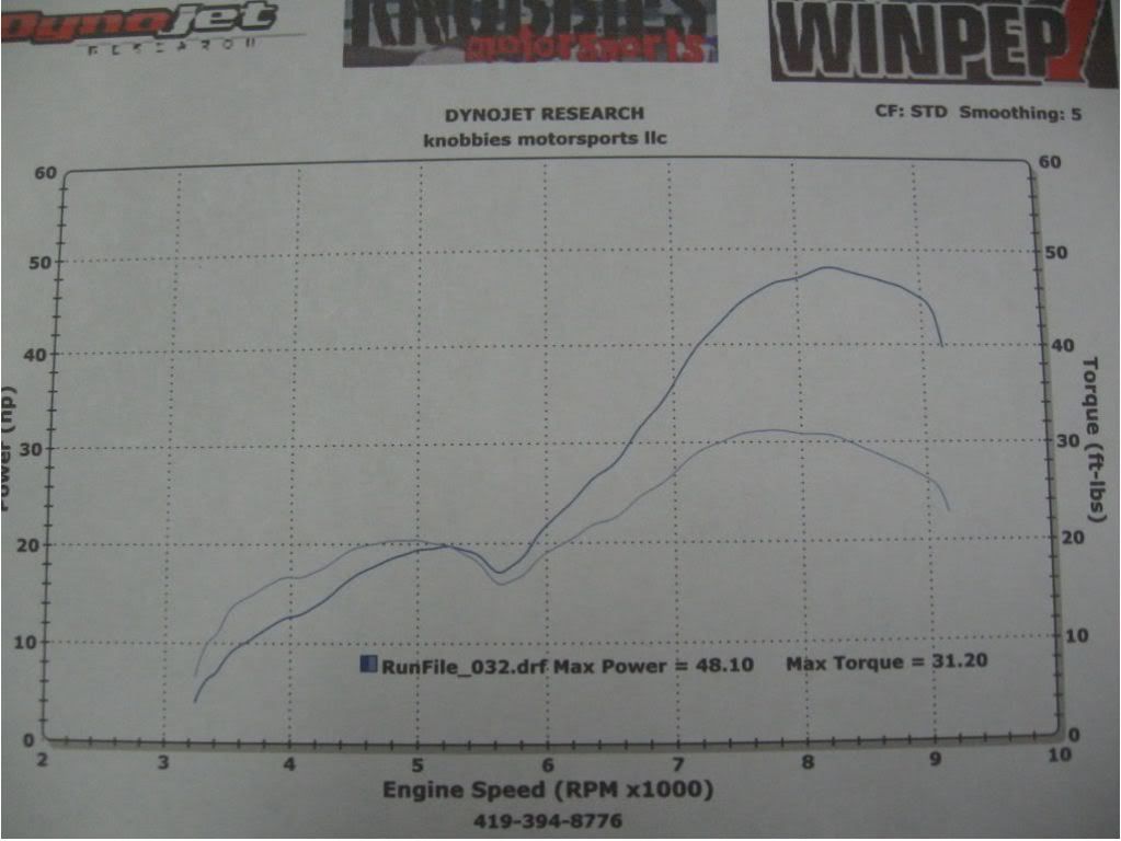

    I bought a 310 kit from ESR a while ago and finally got around to bolting it on last weekend. The kit I got was ported for TT Racing. Below are the dyno results, 48.10 HP and 31.20 lbft of torque. This is using stock carb and airbox assembly with the lid removed. My exhaust is a CRF sectional. I was very impressed with the numbers and figured others would be interested in the results.

    I dont know too much about dyno results for 2 strokes but isn't it weird that your tq and hp both dipped around 5500 and then came back up?

    this is nice too know. wish i could see the numbers with a 38 a/s carb and an airbox delete. the drop off in the middle of the curve tho is kind of weird supposed to be an all purpose port job basically so you'd think the middle of the curve would be steady from low to high. did you do any tweaking with the needle to see if it would take the drop off out or did you just do a few simple pulls.

    Tire spin will cause that dip.

    The dip was due not having the throttle valve and needle jet dialed in perfectly. We were able to tune that out.

    Those are some pretty good numbers!
    Makes me wonder what mine would do as well.. ESR350, ESR reedblock, 38mm AS, ESR ATC5 pipe with silencer, TRX9 porting with race gas dome....
    I need to find someone in my area with a dyno..

    Thats real impressive!

    Xrider those numbers are a few numbers too low for me.
    I recently rebuilt my 88 Trx 250r with a stock cylinder and was dyno tuned by Kenz cycle tech at 51.2hp with a stock cylinder. My 88 Trx 250r has a mild ported cylinder, 1985 ATC 250r head and cylinder gasket, 38mm air srtryker carb, carbon tech ht reeds, ESR trx9 pipe, and no air box lid.
    I'm sure when you buy the 38mm air stryker carb your number will go up and will be your best bang for your buck or you will not be disappointed when you buy carb. Good luck with it and enjoy riding her.
