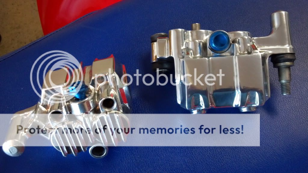

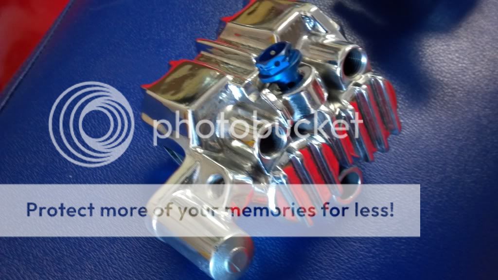

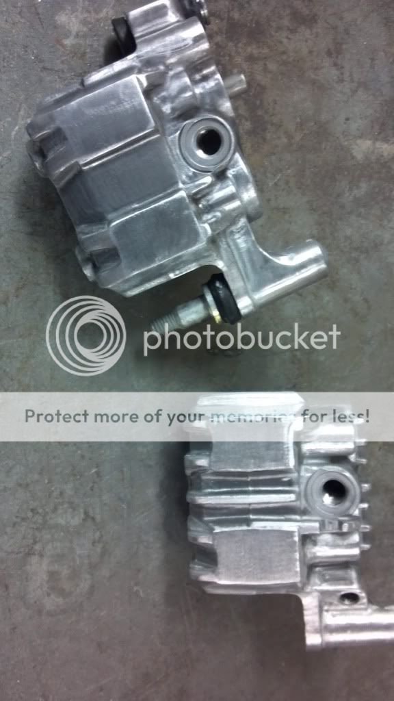

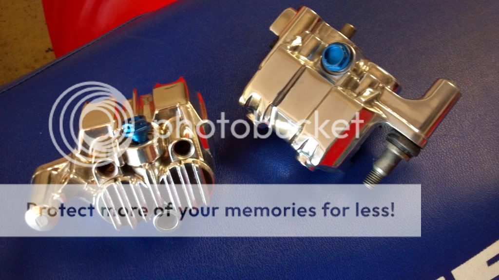

    I'm pretty proud of these I put a lot of work into them
    Before
    After

    And you're gonna Ride this????? Beautiful work !!

    You can definately tell you put your time in on those calipers. Did you do all that by hand? Looks Great!

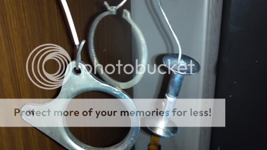

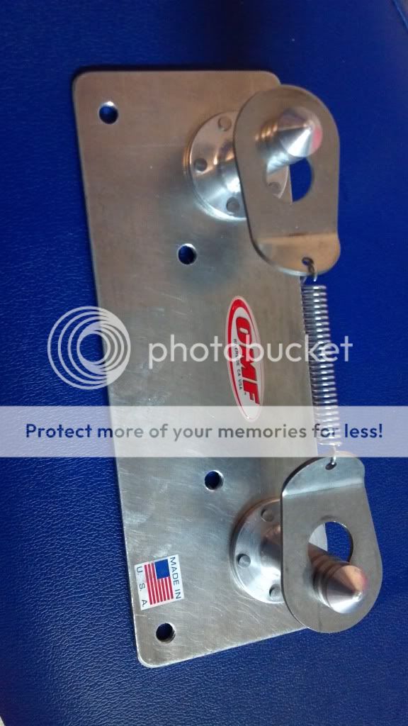

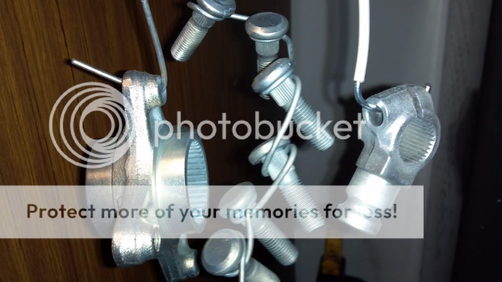

    Zinc plated a few more parts
    Omf seat latch

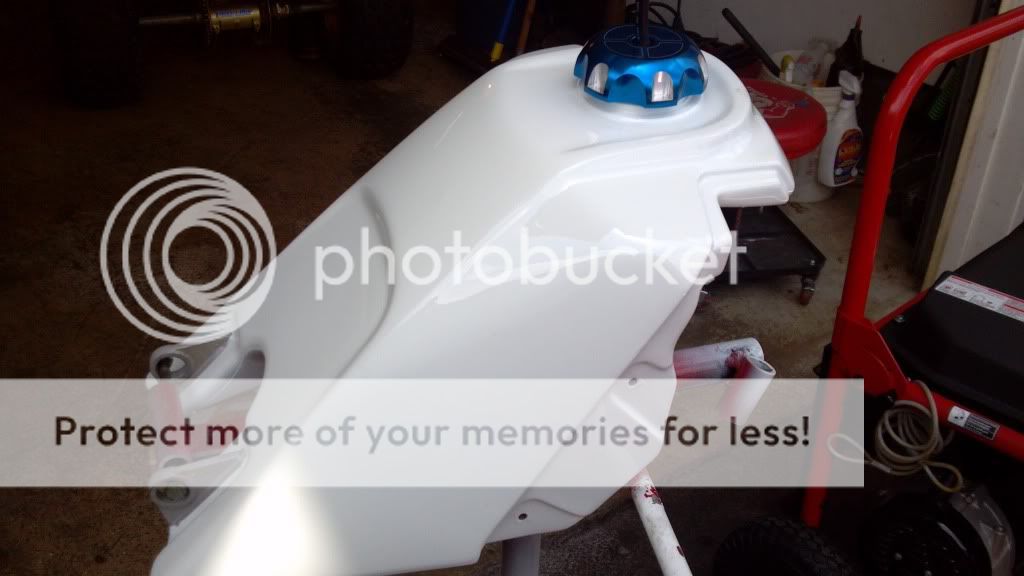

    The Gas Tank

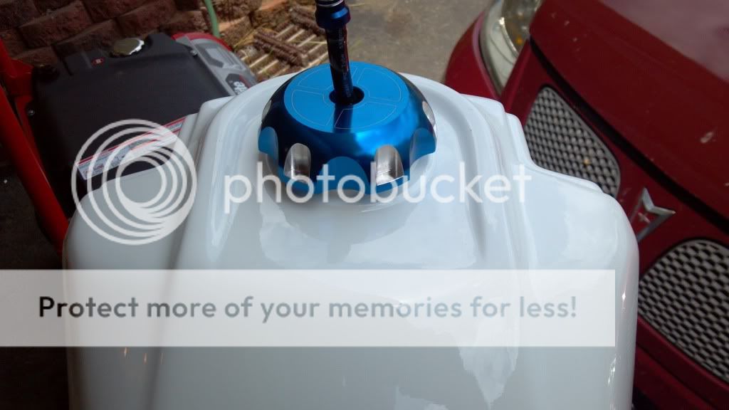

    So I bought a Clarke white gas tank and it fit ok but I wanted more depth and shine so I decided to paint a stock tank (I know what your thinking ). I bought the Caswell epoxy tank liner kit
    I first washed the tank out with acetone ,then put drywall screws in the tank and shook .Per the instructions washed out with Dawn dish detergent and then the Acetone again.Mixed the epoxy together and poured in the tank .Rolled and shook tank for about 15 minutes then poured the excess out. Once the epoxy cured it created a hard slick surface inside the tank.
    Glass beaded the outside of tank

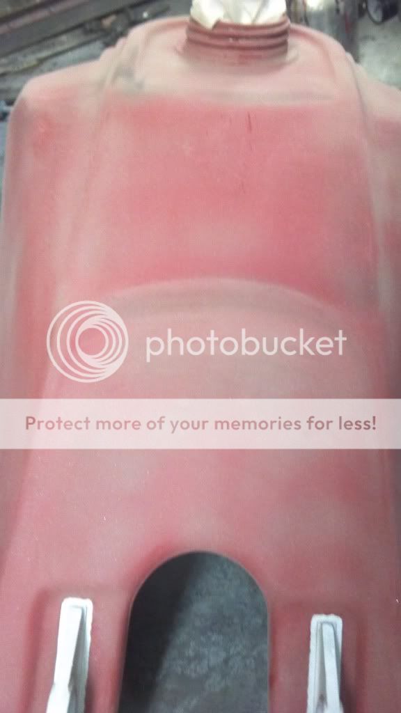

    I bought PPG plastic adhesion kit which includes a primer
    Let that primer dry and and sprayed with PPG epoxy primer
    Sanded and put second coat of primer on
    Sprayed tank using PPG base coat clear coat
    It turned out just as I wanted. If it doesn't work I'll put the Clarke tank back on.But for now I am fairly confident it's going to work.

    Absolutely not a Single doubt in my mind,that tank will look like that 5 years from now. BEAUTIFUL work man!!! I like where this is heading : )
