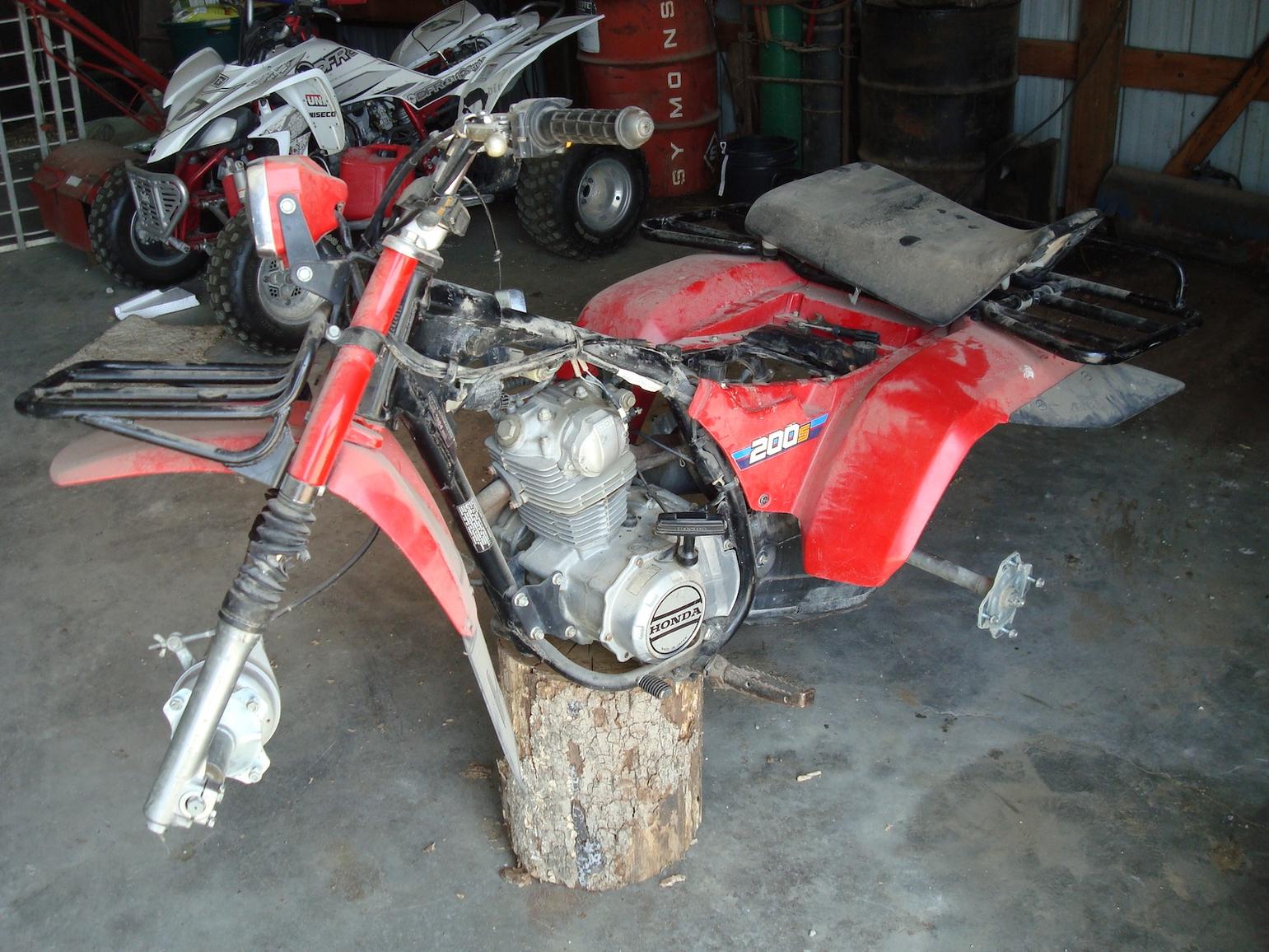

    Thanks for the advice. I ended up going to put the carb on earlier and didn't find the clip when i unscrewed the top! luckily I found it laying on the shop floor where i rebuilt it last night phew. Anyway I put the carb on and a new plug along with fresh premium gas and after sitting for 3 years it fired right up on the second pull I couldn't believe it lol
    heres a pic of it this morning before I put everything back on, Ill post another tonight when I got it all cleaned up.
