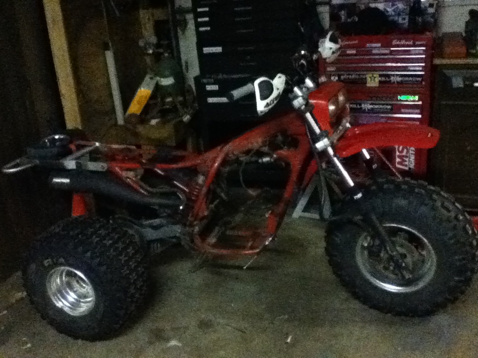

    Didn't get the frame powder coated, but I don't care. If it was going to be fully restored I would, but it's a rider so I left it as is and just did the engine. Got one picture of it on the stand in the shop and a quick clip of it idling today. Going tomorrow to get the carb set. It bogs a little in the last 1/4 of throttle, shouldn't be hard to fix. Also have my jeswinehart number plate on now too

    Messed up on posting the clip. It feels alot better now with the engine work I did, it will wheelie just with a quick throttle punch
