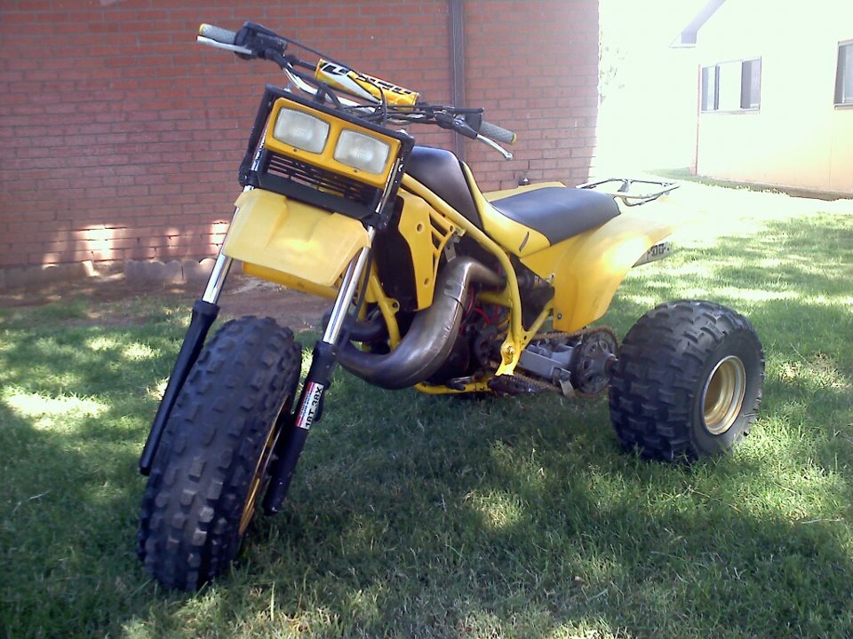

    I just bought this 1985 Yamaha Tri-Z and had some questions:
    1. It came with a manual, but is very faded and has some water damage. Is the air screw 1.0 or 1.5 turns out? Is the pilot a 40 or 45, is the main jet a 470 or 420?
    2. The holes in the rear wheels are oblong, what size wheels (bolt pattern) do I need to get to replace them?
    3. I am not familiar with the 2 fuel petcocks, what's up with those?
    Thanks for any info that I may have forgotten to ask.

    Welcome to the forums, main jet is 470, 1 turn out, and turn both of your petcocks on. Im a new Tri Z owner myself, Ive got the service manual on cd. The pilot jet is 45 too.

    welcome. one petcock is on\reserve, the other is on\off. good luck with it, they're fun machines!

    Order yamaha blaster wheels the lug pattern is the same, or buy banshee hubs and banshee wheels which is desirable setup as the availability of wheels for that lug pattern are easy to come by.

    Not sure about the 11" front wheel. Rear bolt pattern is 4/100. Here's a great site for bolt pattern information:
    http://www.myboltpattern.com/Yamaha-Bolt-Patterns.php
    Because the Tri-Z tank is under the seat and can not gravity feed to the carb there is a fuel pump. The petcock to the back of the back is your "on/reserve" selector and the one toward the front is the "on/off" from the fuel pump to the carb.
