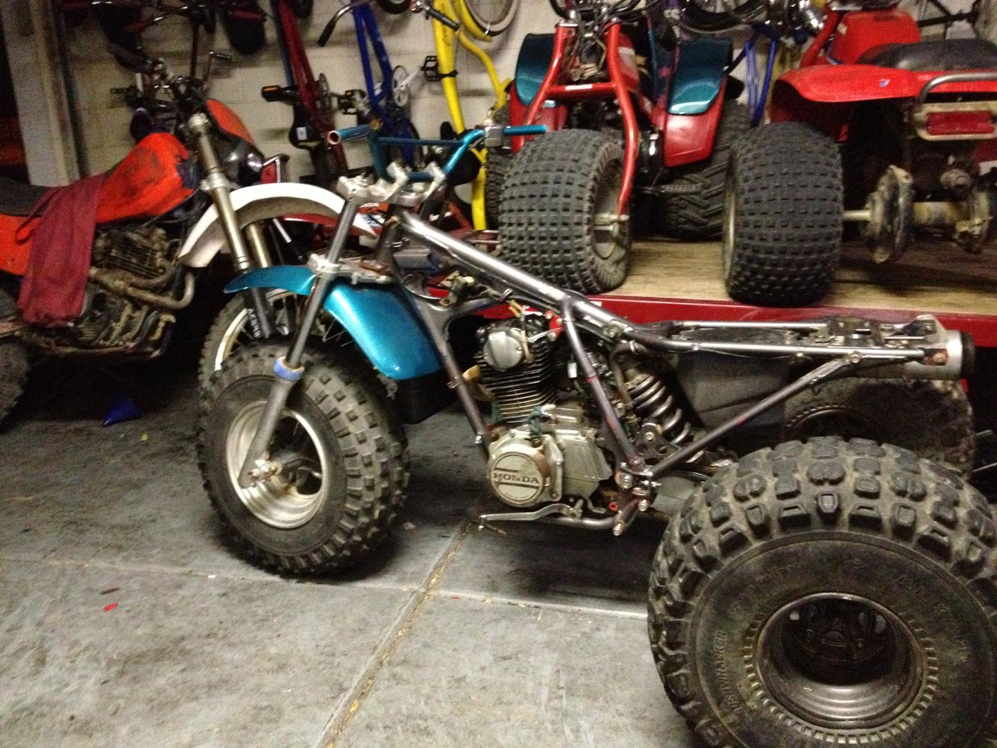

    Well here is an update about a month ago I took the valve cover off to check our the valves I noticed that the decompression valve assembly was messed up on the 185 motor, so I decided to clean up the spare 200x head and valve cover I had. I disassembled the top end of 185, the cylinder and piston still look good so I replaced the gaskets and put it back together. I installed the motor checked for spark and won! I bolted the carb up and tried cranking it over with some staring fluid and got it to fire so it looks like I should be good to go. Hopefully I can put the chain and exhaust on this afternoon.
    I'm gonna head down to the grocery store and pick up a 2 liter of coke to clean out the rust from the tank. I'll post some pics later today
    I'm bringing the 80's back!
    85' 200x - 84' 185s - 85' 125m - 83' xr500
    Nov 2012
    Phoenix
    135
    Last night I got the Chain on, Exhaust, Breather tube, the boot connecting the Carb to the Air Box so it should have everything it needs to run. I connected the tank from my other 200x and pulled on the cord for 15 mins or so but no luck. I have spark I was spraying starter fluid straight in to the carb, then I connected the boot because I have heard the 200x can be kinda picky when it comes to back pressure still nothing.
    Here are a few pics of the progress a long the way:

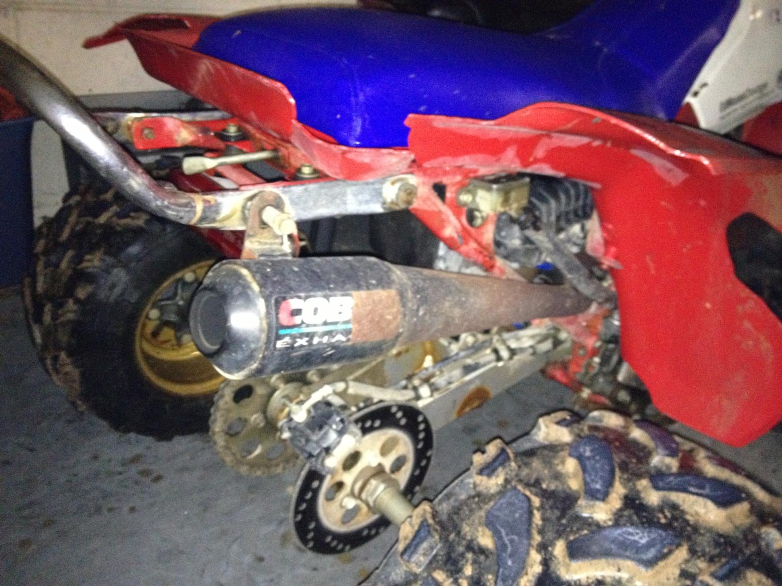

    What are the difference in performance between the Cobra stingers and the Supertrapp Stingers? I have both available and want to Build my other one up a little more, and this trike needs to be less aggressive.

    Well I think I need to rebuild the supertrapp stinger, I swapped it out to my newly rebuilt 200x and it wouldn't start I took off the plate and rings off the back and it started right up. I am waiting for a new fuel petcock and then I'll try to start the 185x again.

    I got it to run today! Man she was smoking! I'm gonna keep starting it and running it a few minutes at a time for the next couple days and see if it clears up. The head came off my other 200x it didn't smoke before I tore it apart.

    I rode it around my neighborhood yesterday, still plenty of smoke. I'm thinking it might be the valve seals. Time to take the motor out again and open it up

    Can you take a picture of your carb and how it clears your rear monoshock? I have a 185 just like that. I bought it for 200 bucks and it needs a lot of work. I saw you talking about the 185 intake manifold and how you need the 200x intake manifold. I think the guy was running a 185 manifold because itcleared the shock by about 5mm. Now I know . Will probably be buying a new manifold this summer once i get out to that thing.

    Sorry ngunter2 the trikes across town right now may be a week or so before I see it again, I have an extra 200x in-take I can snap a pic of if you want

    Well I finally got around to tear the motor down again. Rings were bad, I decided to hone the 200x cylinder I had and got a new 200x piston. I should have it done by the end if the week. I have been really busy riding my new 350x
