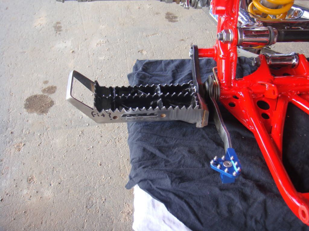

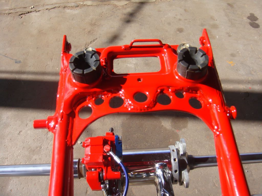

    here are a few other goodies i am going to use on this build,, going to adapt these roll pegs, going to mpount 2 of these LED light bars,, and try to see if i can figure out a place for the stabilizer ..

    well i finished all the bottom gussets,, its real nice to have a 70 ton ironworker, it makes punching the holes a breeze i have 3 of them on the shop so i don't even have to keep changing dies.. i am going to address the downtube from advice from a fellow 350x expert,, and then let the paint flow,,, can't wait to get this thing ready for a dune trip,,5565

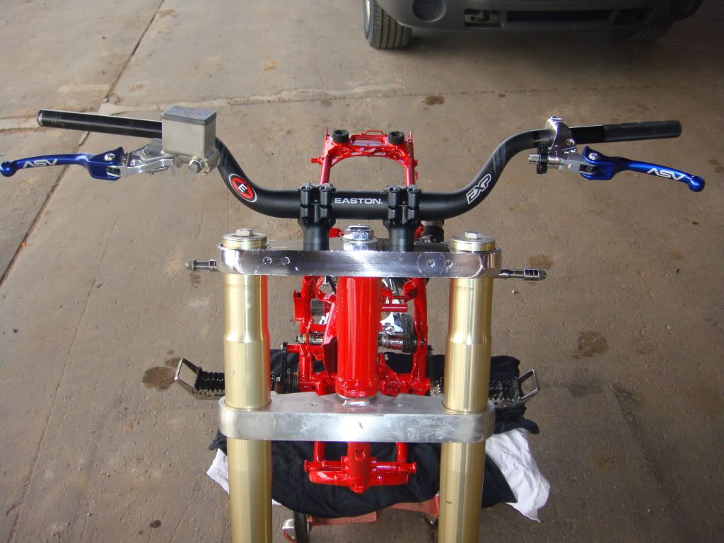

    ok here is a little more progress,, its starting to actually look like something,,,,

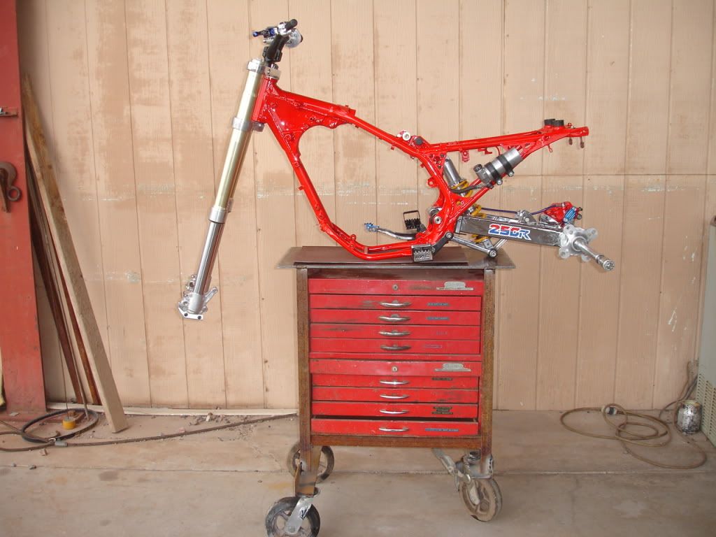

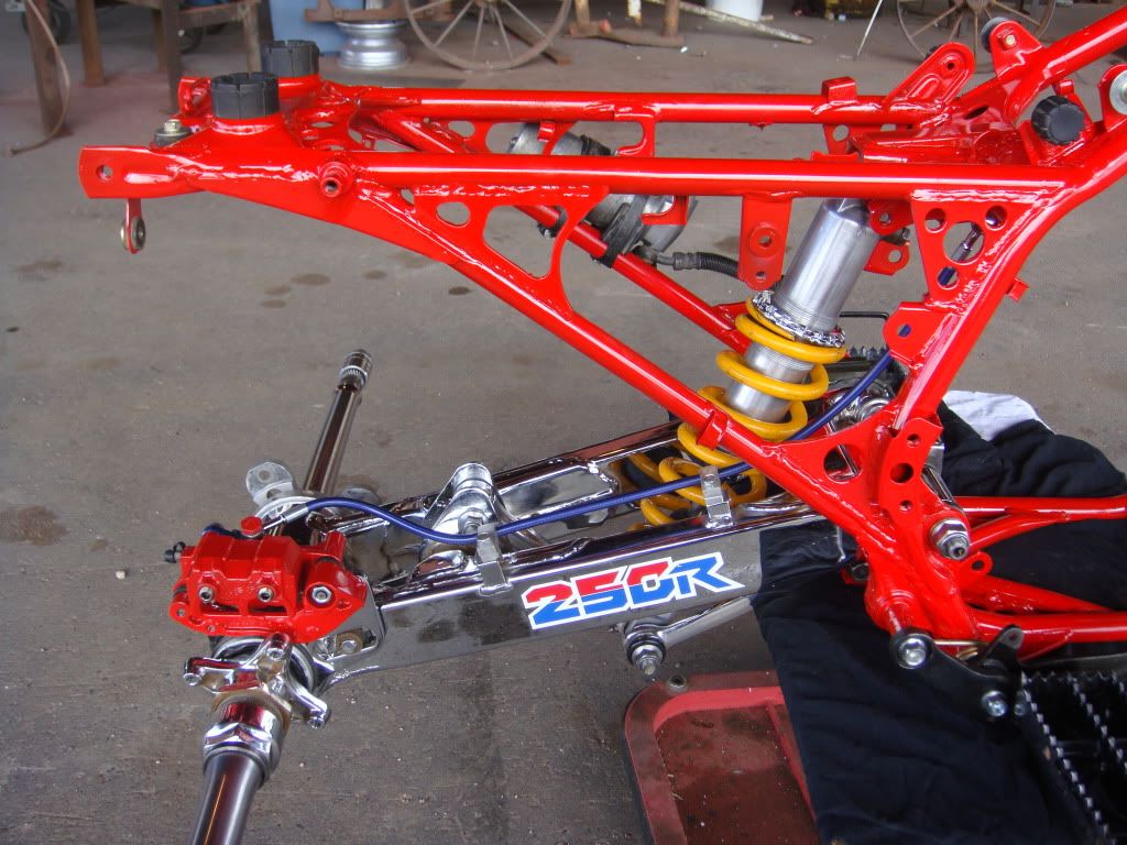

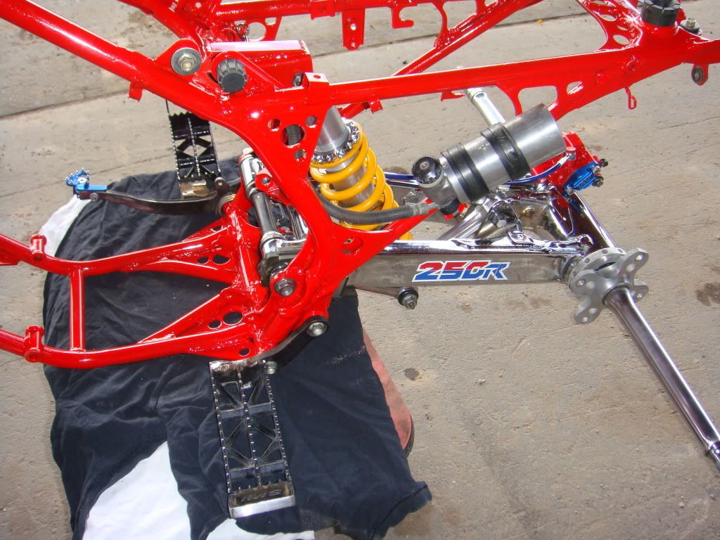

    Alright I'm confused. I picked up on the 350 frame right away, but now the 250r decal on the swinger has me stumped. Powerplant???
  10. #40
    KASEY's Avatar
    ARIZONAS BIGGEST TROUBLEMAKER
    4,239
    85 350x frame. 86 ATC250R REAR SUSPENSION. its still a 350x.. just has a little better suspension,, the swinger is 86 250r the rear shock is 89 trx 250r heavier ohlins spring . the trx swingarm is +3 to stock 350x so i end up with an extended swinger which is way better for the dunes,,

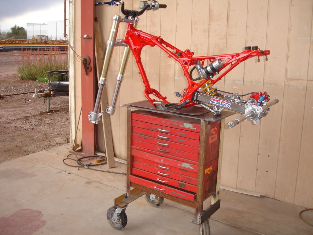

    no porgress on the trike today... BUT i got tired of flimsy stands and low working areas!!! my old knees and back said FIX IT PLEASE!!! so today i took a couple of spare tool boxes and made a 3 wheeled rolling trike building stand!!! now when i work on something i can put all the parts in drawers and remember where they are!!!! AND NO i don't use the same perameters when building tools as trikes... it will never get painted or tricked out,,,,,
