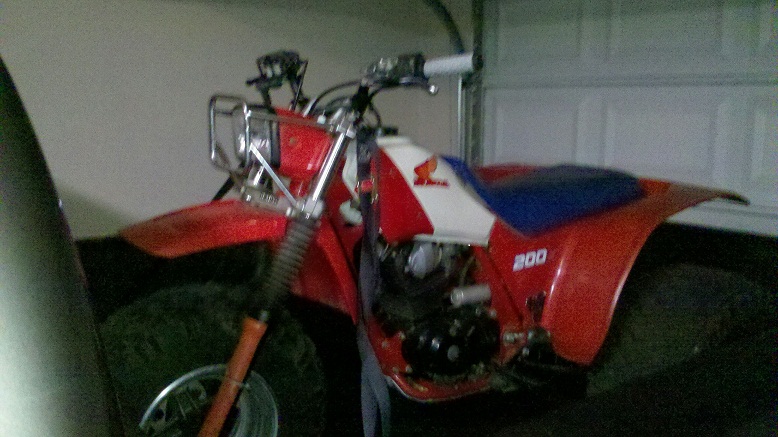

    Well I took the dive and picked up a super clean 83 200x for 500 bucks. Came with a brand new PRM skid plate and sixpack rack. Also included was an extra rear
    shock, that's because the one on the bike is blown, new fork boots, Honda service manual, new grips, and new seat cover. Plastics are in amazing shape and
    the bike has everything from the head light to the stock exhaust. So now for some details. Started to work this thing over today and noticed some things I
    didn't see last night when I picked it up. jb weld on the oil drain cover!? Haven't had the guts to even try and pull it off yet. also some jb weld on the fork
    bleeder at the top where it threads in. Exhaust is rotted out on the end of the silencer at the welds, tires are rotten, and one of the rubber fender cushions was replaced with masking tape, and to top it of the rear brake assembly is gone. So looks like I have a little bit of work cut out for me but that's the beauty of it I
    guess. So ordered tires, the rubber cushions x2, new spark plugs, used brake assembly, new air filter, and as many stock parts that I could get of off bike bandit.
    Coolest part I took off the crappy blue seat cover to replace it with the new one and low and behold the original seat cover was underneath and is flawless. I
    decided to just rock that instead of the new one. I drained out the old gas and removed the air filter and gave it a good cleaning. Day one down tomorrow I will
    Post pictures and continue to disassemble and clean. Any thoughts on the drain cover?

    Ok so here are some pictures of what I was working with. So basically Honda guy had it figured out. looks like the cover either got over tightened or it got hit and cracked. Tons
    of jb weld on the frame and in the threads on the inside of the case. Cleaned it all up drained the oil, drained the old gas and cleaned the carb. Just waiting on some parts got the drain cover x2 for 8 bucks. Will post more once some of the parts come in. Also i knew this thing was old but using motor oil to lube the filter and solvent to clean it! thats
    awesome. If i dont have any solvent I will use some gasoline to clean the filter. Only joking. crazy how far ATV's have come. Will post pictures of the exhaust and tires once they come thanks again guys.

    Looks like you got a pretty good deal on that it looks clean......
    Good thing it was a easy fix.
