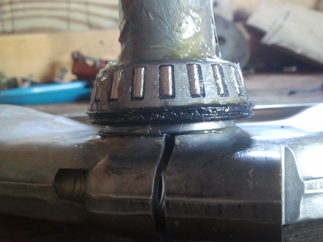

    Yaegerb.. don't even worry about it haha I got it now! I took a big railroad tie(cut at 2ft long) drilled a 2inch hole (just big enough for the bottom of the stem) and I set the bottom triple over that. I put the railroad tie on a floor jack, rolled the jack over to our mudder jeep with a HEAVY duty bumper on the front. Put the nut on the stem and jacked up the stem into the jeep bumper. Lifted the jeep about 6inchs lol and I jumped onto the bumper. All the weight shot the stem out just like a press Home made press for the win! I took the washer off, threw the bearing back on the stem and put it all together. This is where I'm at now
