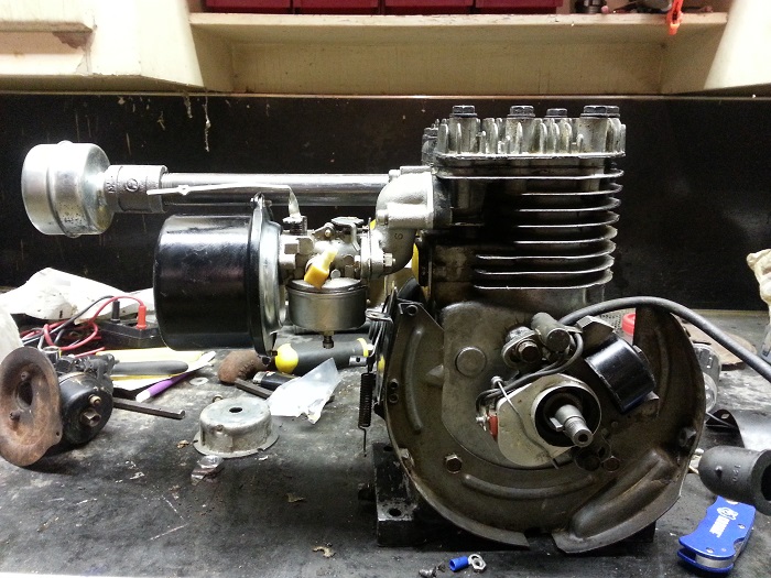

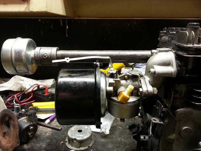

    Update:
    Finally got spark. The points were corroded and it wasn't ground properly. I used an omh meter and everything checked right, also I knew I was on the right track when I shocked myself. Degreased the engine and cleaned the carb. Here are new pics

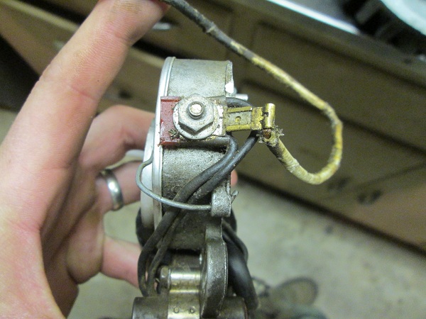

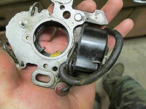

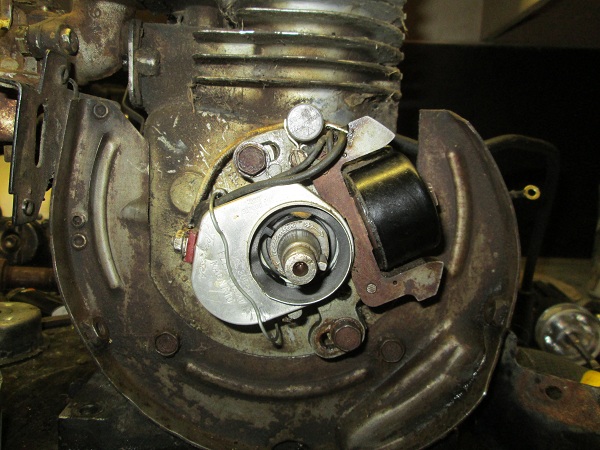

    Well got the pistons cleaned and new carb on. Now I can't get any spark. I've cleaned that magneto and fly wheel. There is a ground wire that attatches to the magneto...is that normal? also when I took it off there was another wire with a stripped end and female end. not sure if it was made for a kill switch but I cant figure out where it hooked on. Any ideas why I can't get a spark? Here are some pics

    This is all I have for now either contact the guy I mentioned above or one of the many mini bike forums on the net or just take it to a lawnmower repair shop and they can immediately tell you what goes where and how to check it. The condenser may be bad try it without first.

    Looks like monroemike may have something up his sleeve. I can tell you this for sure all old school mags work the same so any crusty old lawnmower repair guy can help you, the young ones probably not. It's been so many eons since I have dealt with ine i'd only be guessing other than unhooking the condenser.

    OK Here’s the deal I finally woke up [hopefully]. I do not know your level of electronic experience so bear with me.
    Do you know how to use an ohm meter?
    Do you know how to check continuity on the points with one?
    Have you checked the condition of the contacts on the points?
    TEST
    Inspect the contacts on the points, they are located under the metal plate that is held down by the metal clip. How do they look? Do not clean them yet.
    Check the continuity from the movable arm on the points to the base or from the back side of one contact to another, is there continuity? If not this is good go to next step but if there is then file and clean points with brake cleaner, reassemble and set gap at .018-.020 and see if you have spark, if there is no spark now remove condenser reassemble try again, if you have spark now you need a condenser if you do not have spark now you need a coil that’s it.
    Next step if no continuity between points – File or sand points flat, clean with non water based brake cleaner, wipe with paper towel to remove film.
    Check continuity, if yes then go to installation test above, if no go to next step.
    Remove condenser wire there must be continuity now if not your points are bad.
    Get new points and reinstall condenser and do installation test above.
    That's it your done hopefully

    I agree with whats been posted already, i had to work on some old Tec motors like that, need to dig into the points. The points and condenser can both be replaced with common parts from other models. The last one i had to work on i bought a complete kit off ebay with the points and condenser.
