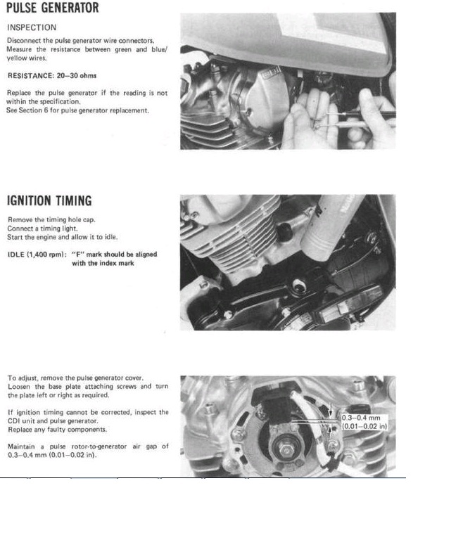

    With the help of some members here, I'm working through some ignition issues on my 84 200es.
    See the attached file someone sent me:
Name:	Ignition Testing-2_Pulse Coil_1984_Honda_ATC200ES_BigRed.jpg
    According to it, the pulse coils should have a resistance of 20-30 ohms.

    I put a different stator in. Now I get 205 ohms. Still no spark. Thanks. I got 29 ohms now from the pulse generator(put a different one on). Good thing I found lots of extra parts.
