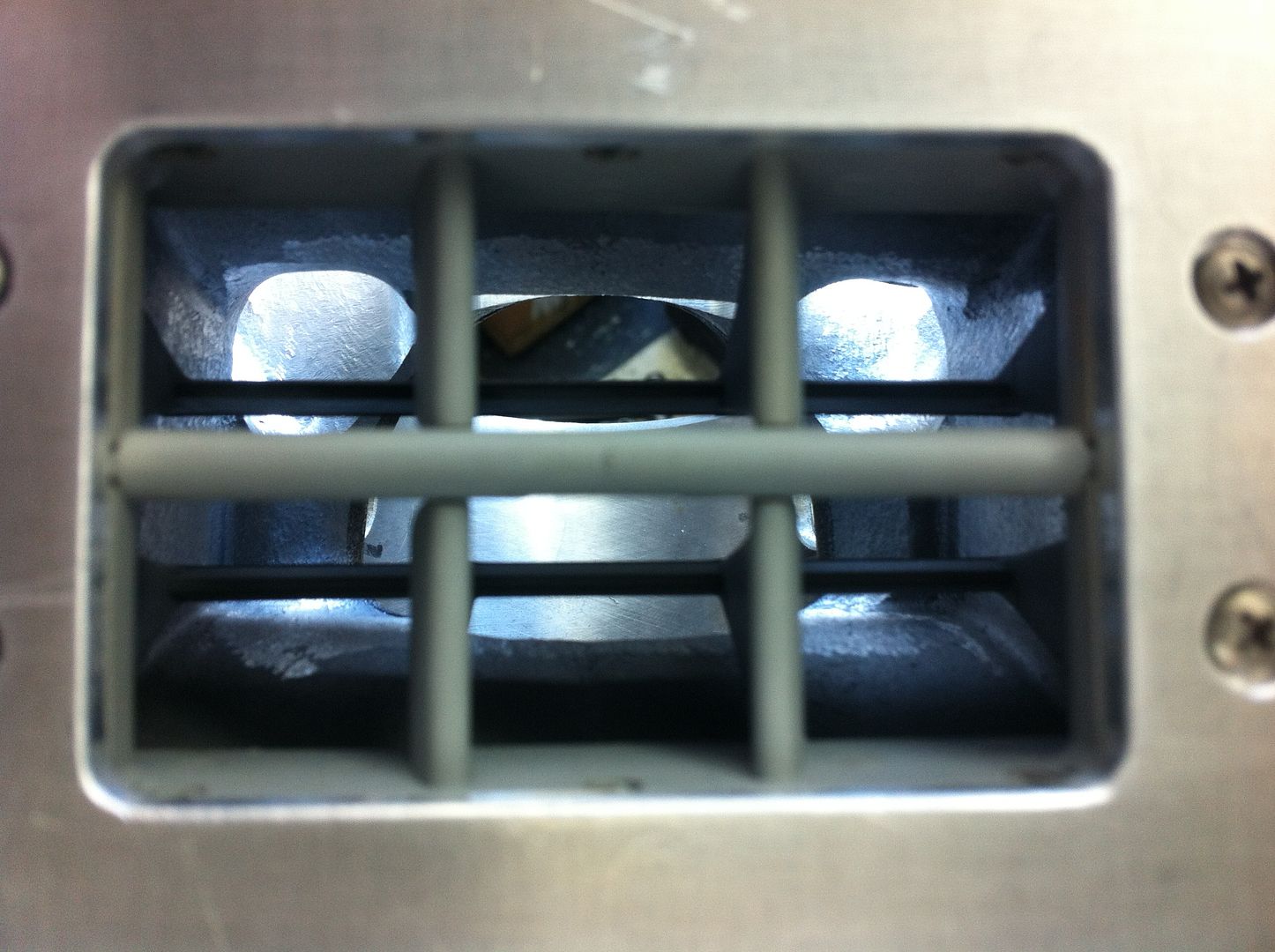

    just spoke with Adam Millar. Cylinder has been bored over and ported. cases have been bored and he's cleaning some other items up in the parts washer now. Theres a few items on the cases that are going to be welded/repaired as well while he has them. He will be sending everything back bare and glass blasted ready for some paint. He is also sending back a set of CNC machined stator and clutch covers, along with a custom reed cage with carbon fiber petals from VForce. He is basically making his own version of the vforce2 reeds for the cr5 motors and has been waterjetting the flanges out and having VForce make petals to his specs that function best with the cr5 motors. kicka$$ stuff. Should have everything wrapped up for me end of next week. SOOOOOOOO then it will be a mad dash to assemble the motor, paint it, and make the bike functional again by March for the Invasion. MUST. WORK. FASTER.

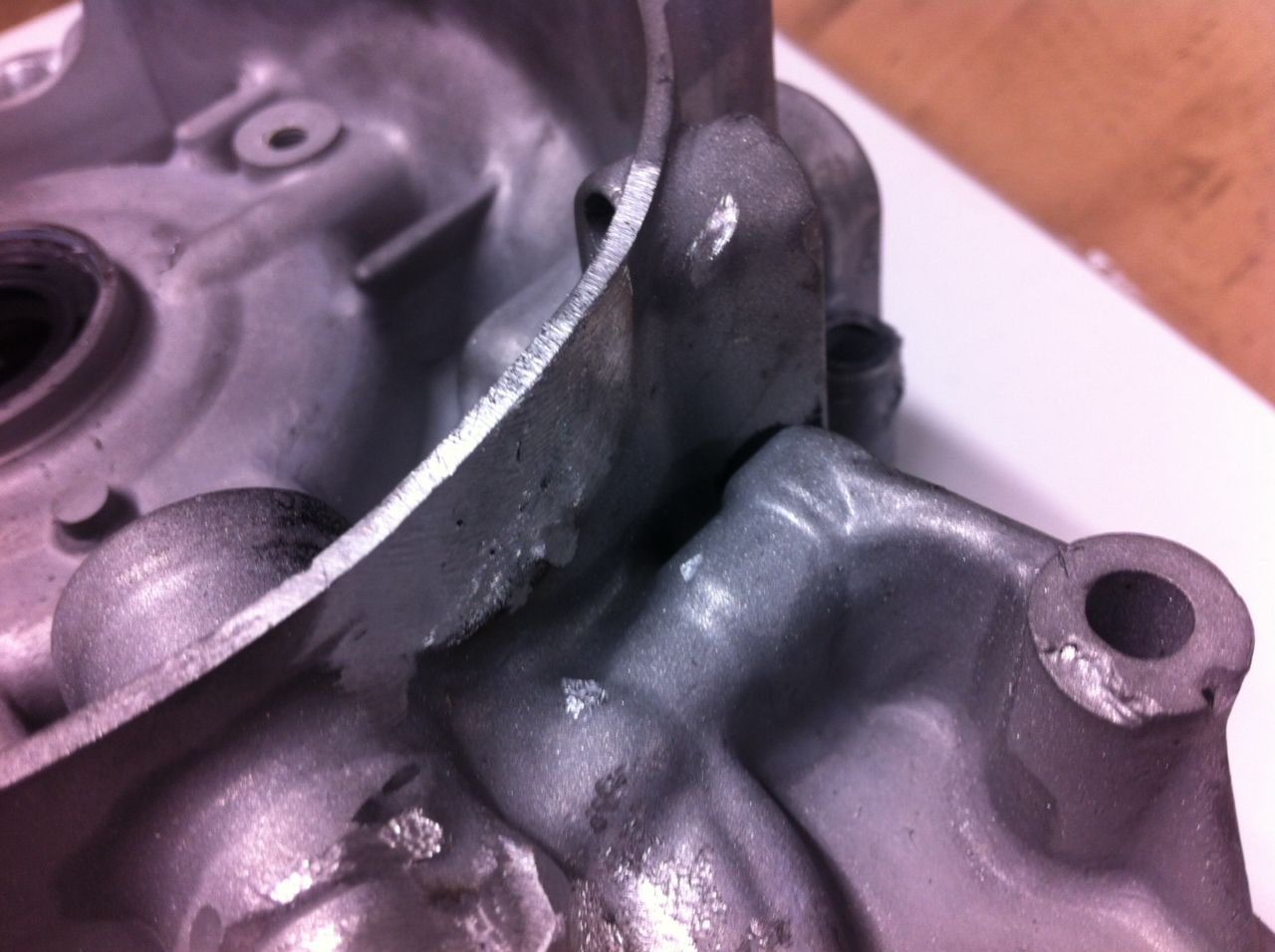

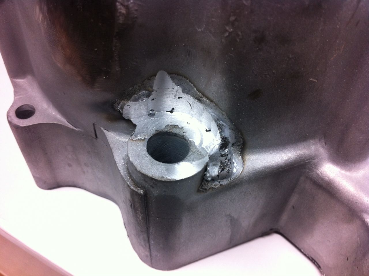

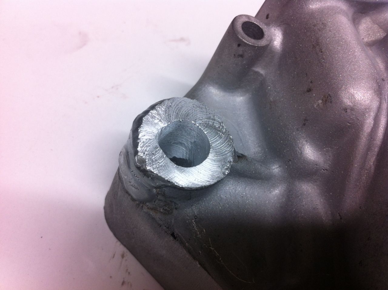

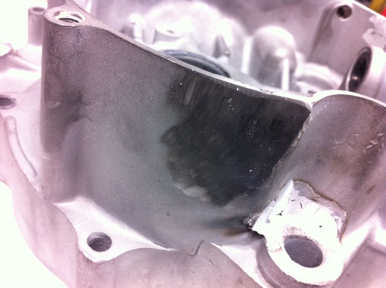

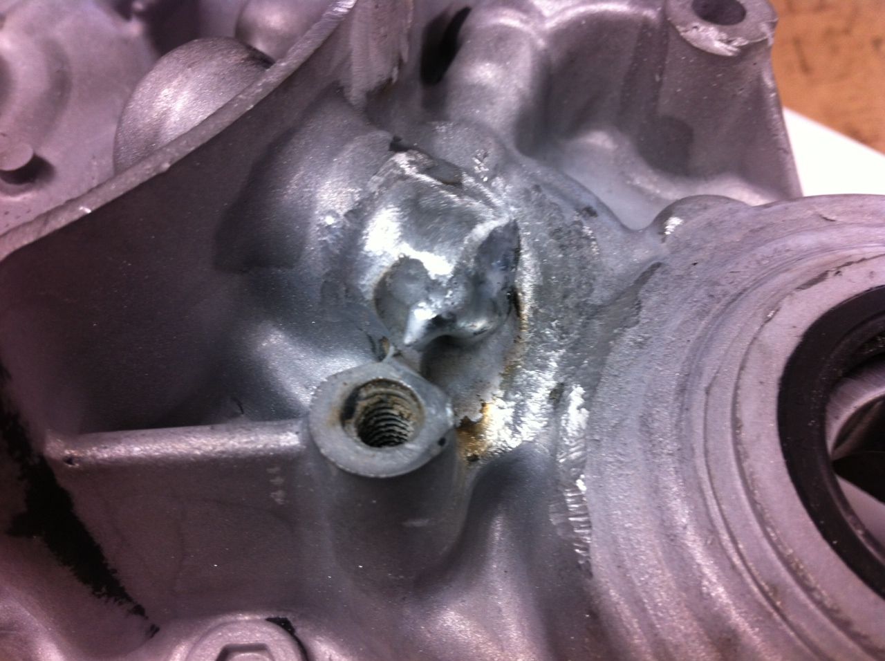

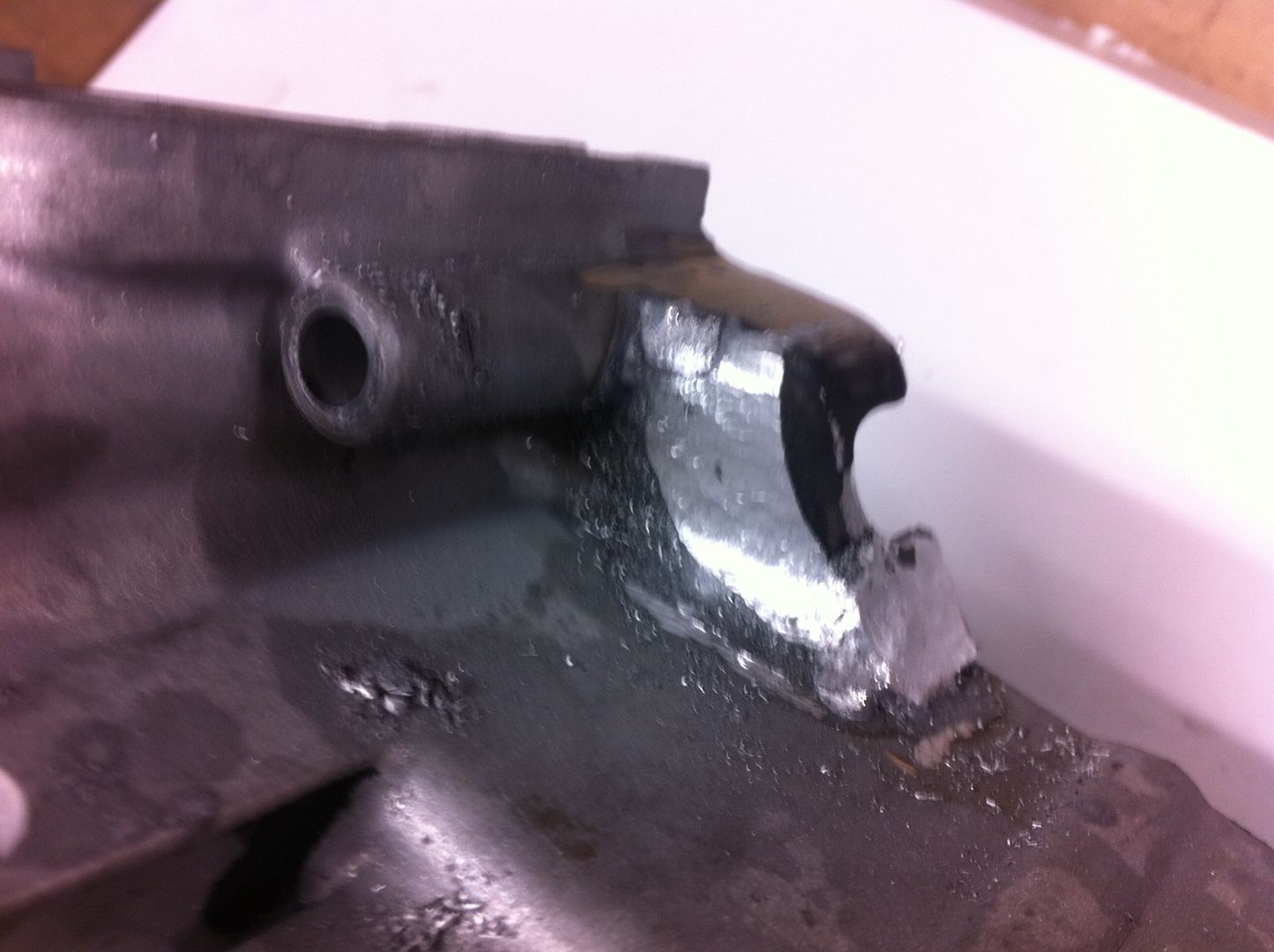

    My cases were a bit beat up, they welded a handful of spots to repair odds and ends like where jb weld was hiding a hole a chain punched in the case. And some engine mounts were chipped etc.
    When I get everything back the plan is to slap it together with all the goodies I have sitting in the shop. Closer and closer. Ordered a set of 2001 cr125 forks and rebuild kit last night, they are headed out to be shortened and rebuilt while the tripples are being machined.

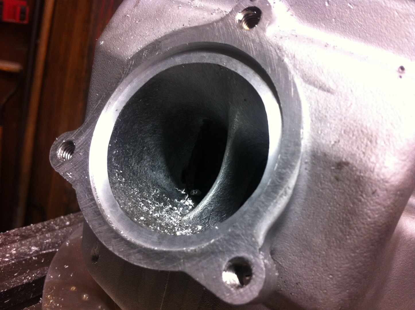

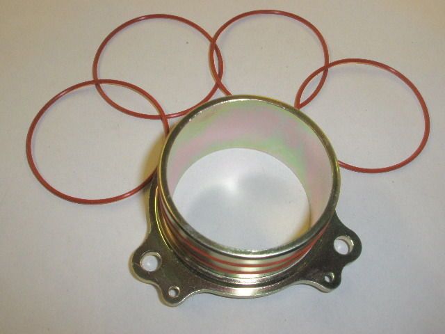

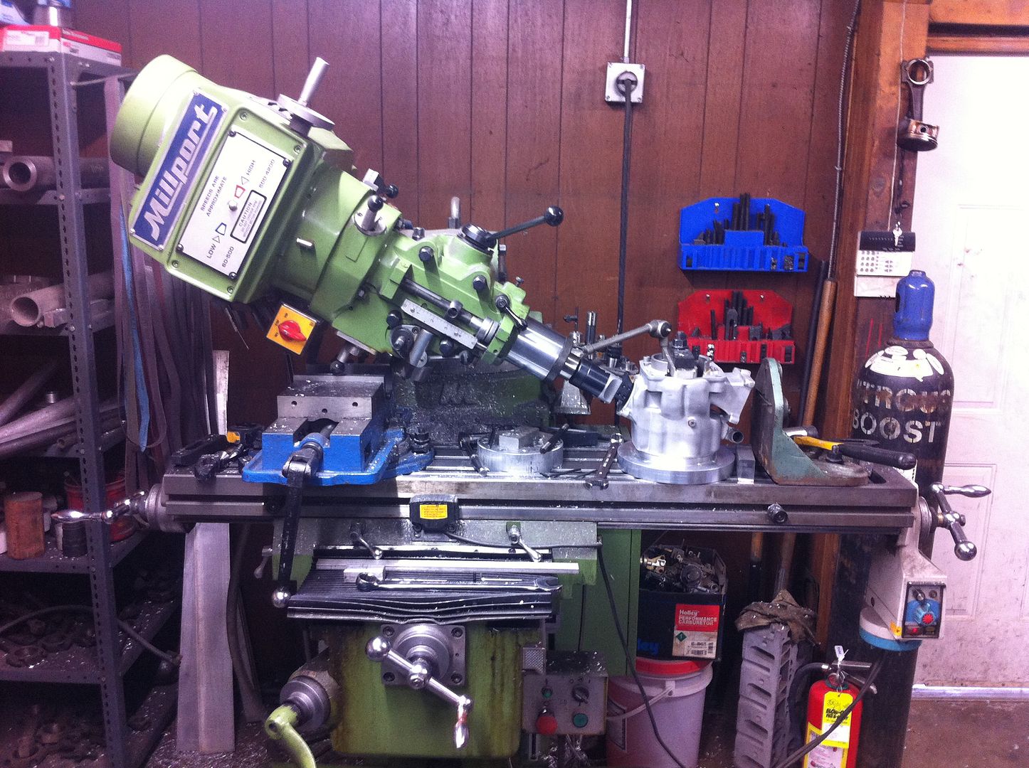

    Ended up needing the exhaust flange machined and the threads in all three holes there needed some love. Also upgraded to an oring exhaust flange. Pretty gangster.
    Tasty port work
