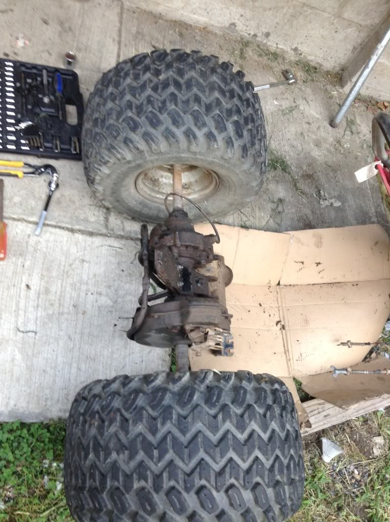

    Rear end off

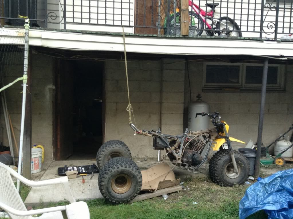

    Back yard engineering, a atv lift.

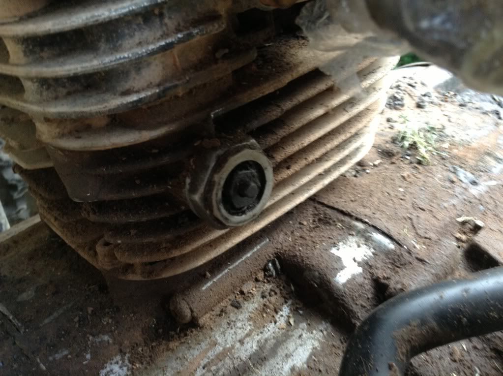

    What is this? When the engine is running that little pin goes in and out. No idea what it is.

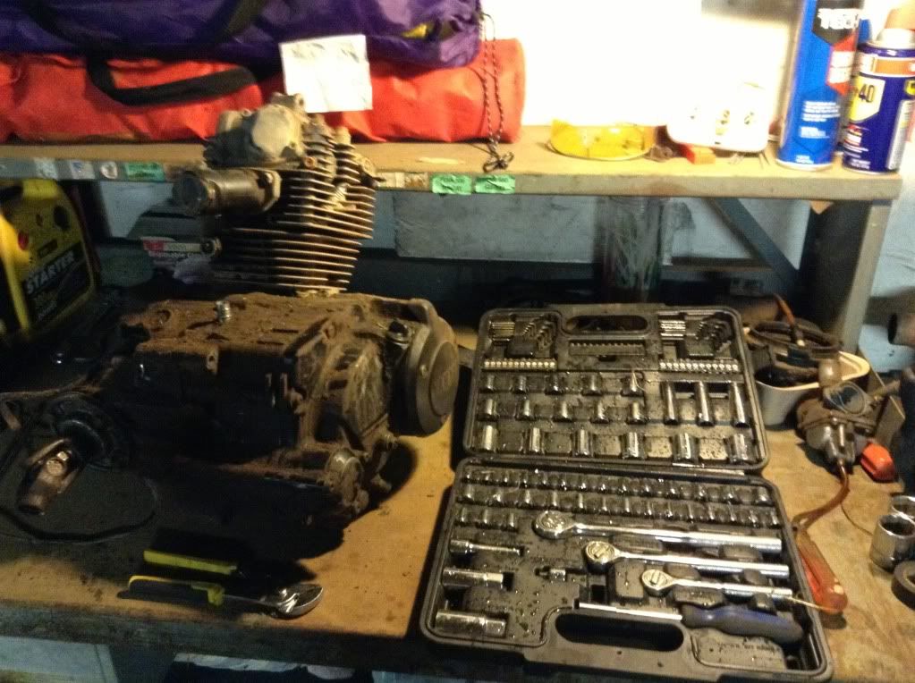

    Got the engine out finally, super tight in there.

    Now on to the motor work. Should take some more pics as soon as its cracked open.

    Hope you enjoy the pics, learning as i go, never rebuilt a engine before. Or really did any of this stuff. Would really like to know what that pin thing on the engine is for.

    that little pin is part of the cam chain adjuster and by the looks its way to tight.it should be flush when engine is off.

    Thanks, now i know what it is at least. Is there suppose to be a cap over it? I have been struggling to find a good manual. Only one i can find is just the normal operators manual, how to ride, change oil, not the stuff i need.

    that cam chain is toast,they arn't expensive. the bolt should stick out an inch. then theres a lock nut on it ( 24mm) and a plastic bolt (cover) for it.
