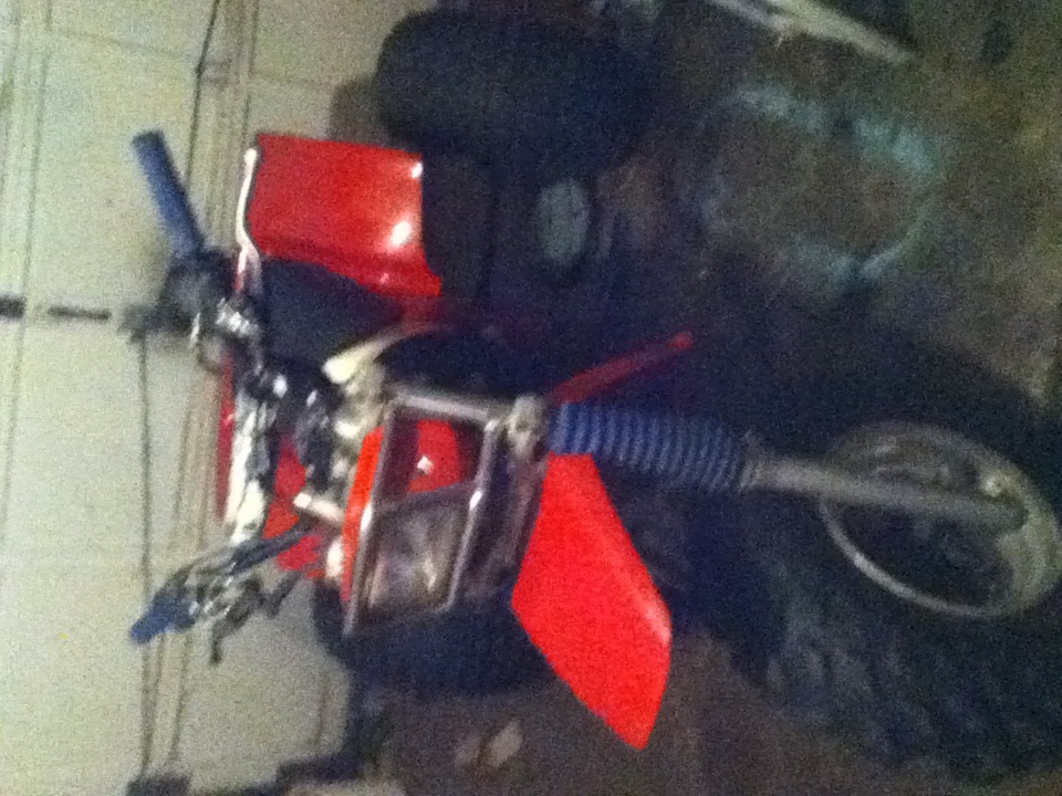

    Just steady white smoke... Can some one hook me up on a free manual? Or sell my one for cheap Click image for larger version.
ID:	175613so I can do new rings an piston.. Also have two sets of front forks an one steering colem axle rim and tire, and head light Assm. Ill sell for low price or a deal can be made.. The extra head light is not like the Crome in the pic it's the one with black cage over glass
