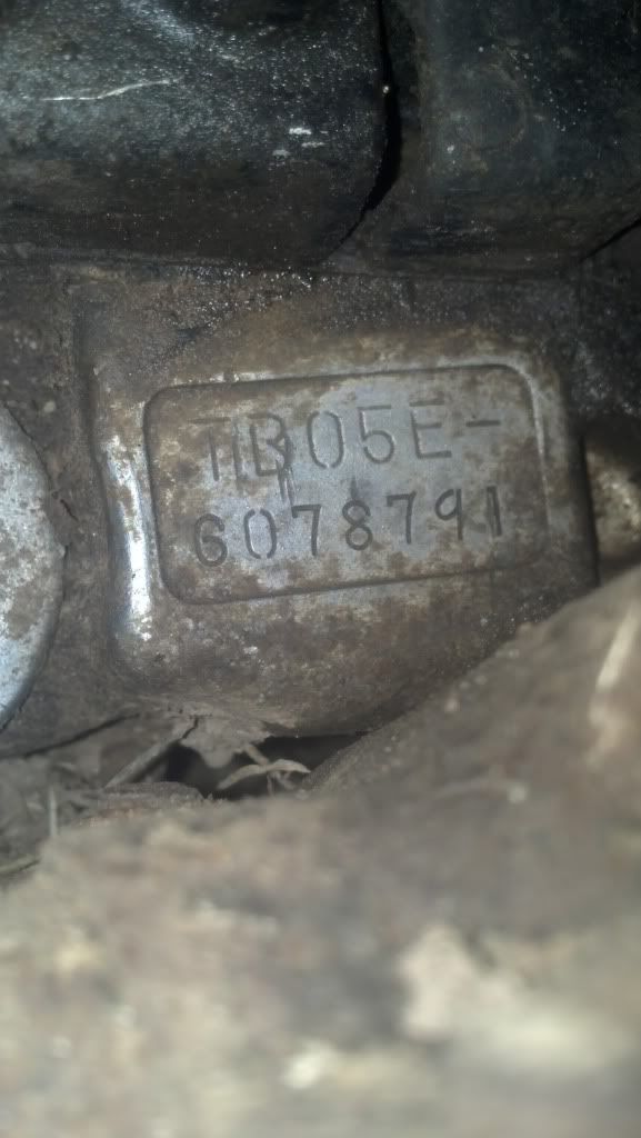

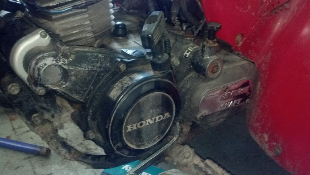

    i just got this atc today
    cant seem to find a vin on the neck but i found this serial on the engine
    and this on the frame
    tried to use the decoder online but it wouldnt take this serial number
    anyone know the specific model for this one? is the engine not original?
    thank you very much

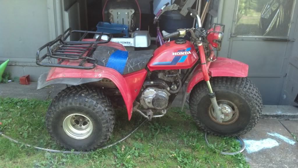

    Looks like an 83 and its got 83-85 200x rear hubs and rims on it.

    Pretty sure it is a 200M. According to the vin decal, it is an '84 or '85 model (depends on the month it was produced).

    according to this thread the engine serial is an 83 200x? or am i reading that incorrectly?
    http://www.3wheelerworld.com/showthr...Serial-Numbers
    should the vin be stamped into the neck or was it a decal/sticker on the neck?
    also if it helps the identification my engine does have high low and reverse.
    what is the lever on the head on the right side near sparkplug/valve cover?

    You may have found an error in the serial numbers, I double checked the manual(s). I copied it correctly, but their info may be wrong. I will update the page, after this is figured out.
    You "might" find a VIN by taking a wire brush to the circled area.

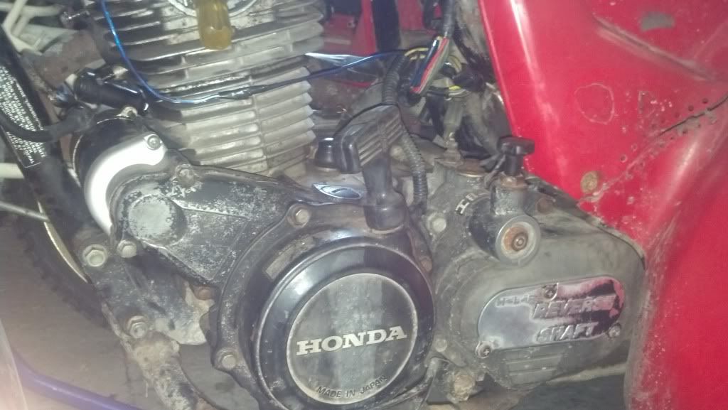

    The lever on the head is a compression release that allows you to use the recoil starter while still retaining full function of your rotator cuff. I see parts from a few different trikes on yours. The tank looks like it came off an S model, and the forks are from a 200M model. If the trike is shaft driven, the engine and frame are from a 200ES model.

    it is shaft driven

    If it has hi/lo/reverse then the engine is a 200ES. Looks like someone frankentriked it with a tank and forks off of other models.
    Edit...
    For some reason when i was on my phone earlier i didnt see the above post with the added pictures... Definitely a 84 200ES motor at least! The rest seems to be bits and pieces from other years.

    The engine is defiantly a 200es

    Looked at your other pics, thats odd there is no VIN on the side of the downtube, there is on every one i have worked on. I am guess its not an 84 200ES frame but rather something else someone cobbled together. I think some of the other years had just a sticker, which would explain why yours doesn't if they took a frame from another year/model. Just guessing though, but that spot you wire brushed is where the VIN should be stamped in for sure!
